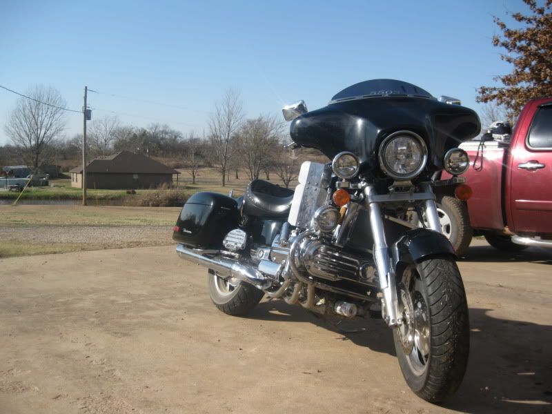

My initial review of the Memphis Shades Batwing, 7" windshield, and pouch system, on 1999 Honda Valkyrie Standard.
I'm 5' 11", and have "The Ultimate Seat" low version.
Ordered from Motorcycle-Superstores.com, 11/24/09.
Arrived 12/01/09.
It used my existing Memphis Shades Fats mounting hardware.
The Batwing, once removed from the shipping box, is sturdy & heavy. So should not move when riding at any speed. (just took it for a ride into town, with 45' weather. Nothing moved, nice fit.
The windshield, is 7" clear. Upon installation, almost 1/2 of the windshield is below the top of the fairing, for added stability.
The 3 pouch assembly, with the plastic mounting backing. Sturdy as well.
It would help if there are 2 people present to help install and secure all pieces, and they all need to be flexed into position. 2 hand annoying, 4 hands would help keep things stable.
Once I assembled everything on the living room floor, and made sure everything was tightened and snug, I walked the batwing into the garage, to be mounted on the Valkyrie.
Since it utilized the previous mounting hardware, everything mounted as expected.
12/3/09 - First ride.
It was 45' this morning when I rode from my house to the local town.
The pouch system is a Pain In The Ass (PITA). It hangs over the Speedo/Tach gauges. No way of raising them from the stock position. Bad design. (1)
The batwing kept the hands from being hit directly. Nice little warm area, kept my hands warm in the cool weather.
The 7" windshield. Nice design, etc. The Bad news. When riding, it deflected right at the bridge of my nose. Looks like I'll need to return the 7" windshield, and get the 12" windshield.
(1) Update 1. Removed the batwing from the bike, adjusted the mounting brackets all of the way to the top of the forks. This made a noticeable difference in viewing the gauges. Will know more saturday, once I go for another ride.
Here is a link to the pics;
Update 2X
Adjusted the Batwing (BW), and mounting brackets, to where the gauges are now visible.
The windscreen now deflects the wind to my forehead. Still not tall enough to keep the wind out of my face
Making some progress in getting the BW to be functional, for me.
It'll be spring before I get another/taller windshield.
I hope this helps some of you make your decisions.

RodMyers
« Reply #6 on: December 10, 2009, 01:11:21 PM »
I took the pics this morning, rather quickly. If anyone wants another view, please let me know.

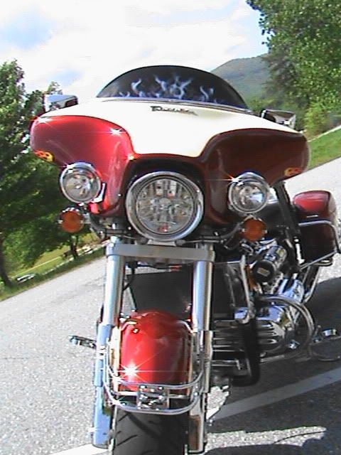

« Reply #15 on: December 11, 2009, 02:54:37 PM »
Here is mine mod using a "05" ultra classic I got off of ebay. I have added chrome lowers and a new "klockworkz" wind screen since this pic.  cooldude

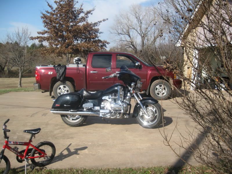

RodMyers
« Reply #19 on: December 13, 2009, 01:48:42 PM »
Here is some fresh shots of mine
Dang, where were you when people asked for pics?   angel
