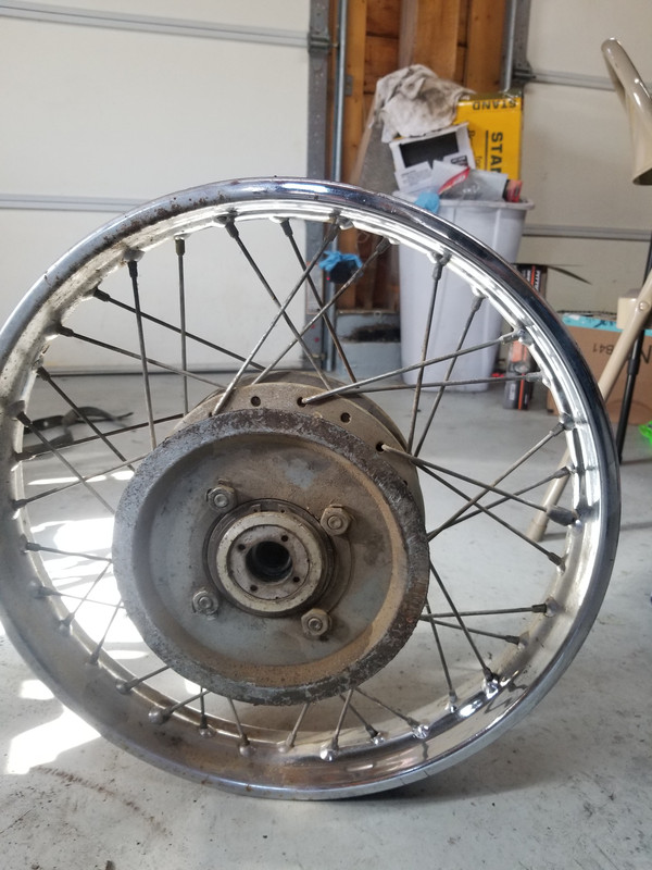

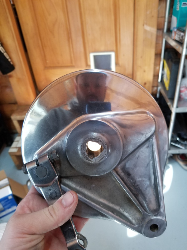

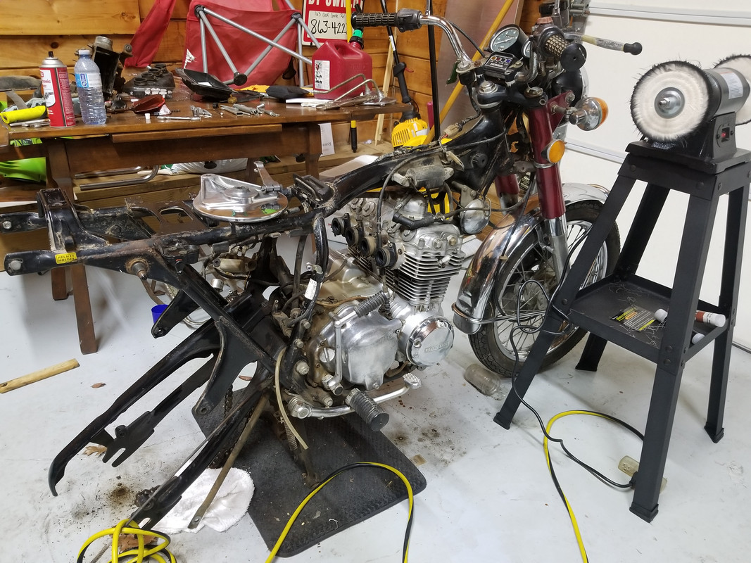

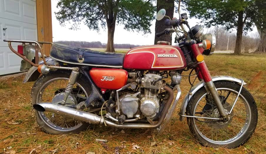

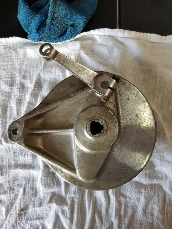

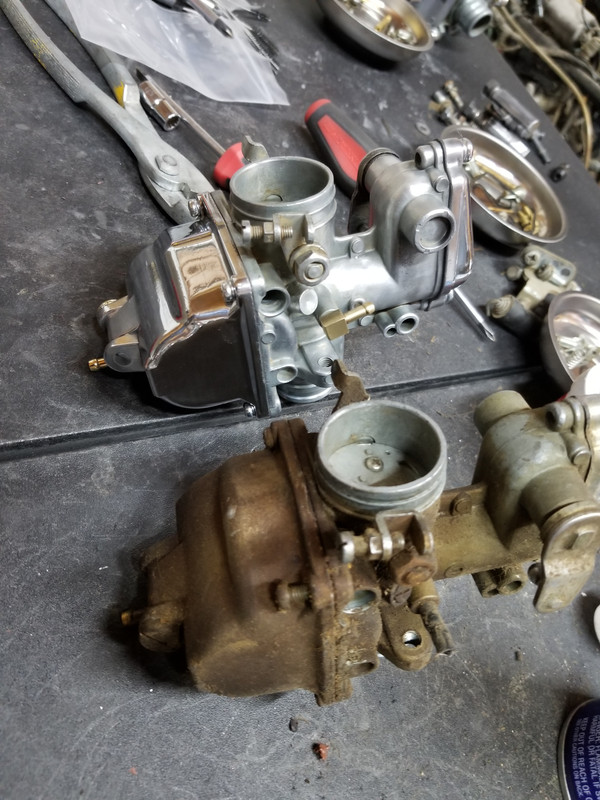

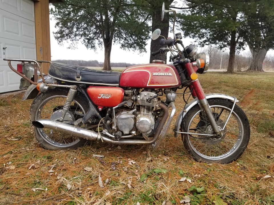

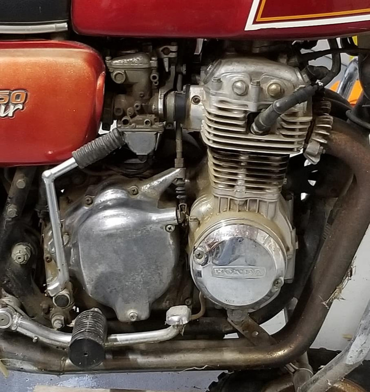

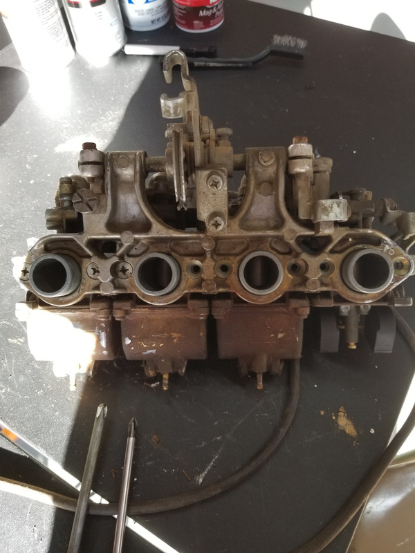

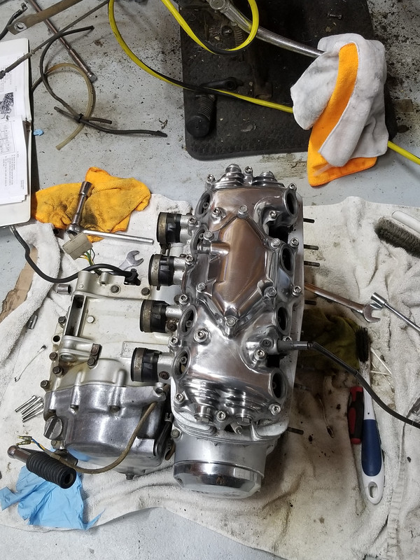

I've been working diligently on the 72' CB350F I acquired over X-mas. Since most of the bike was in fairly good shape, I decided to just do a tear down and thorough cleaning of the frame, engine, wheels, forks, etc.
The frame does has some light oxidation, but not enough to warrant a blasting and re-paint. The 70's paint on the tank and side covers is in decent enough shape, It should come back to life with some compound and polish.
I put a new battery in just to make sure everything is sound electrically. All lights work except for the rear turn signals, where I find a mouse had chewed the wiring in half where the seat rests on the back fender (easily fixable).

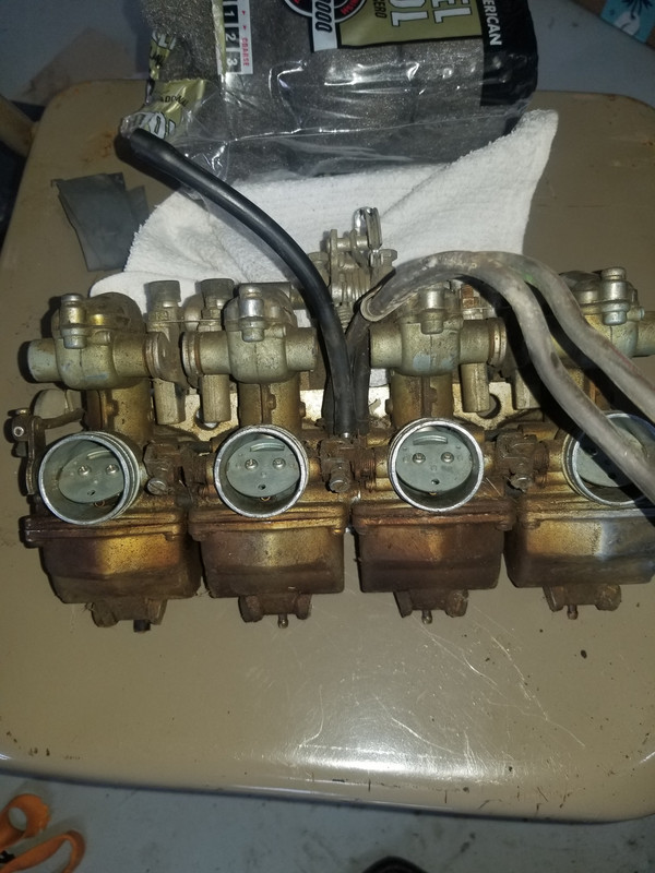

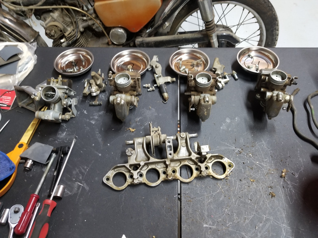

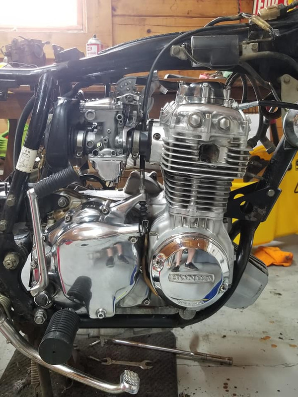

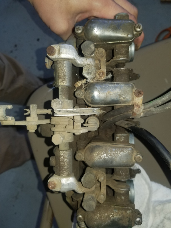

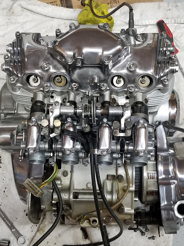

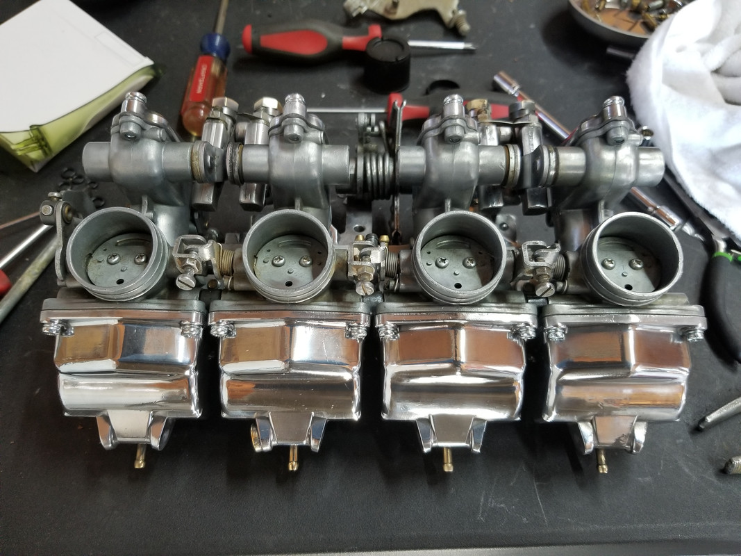

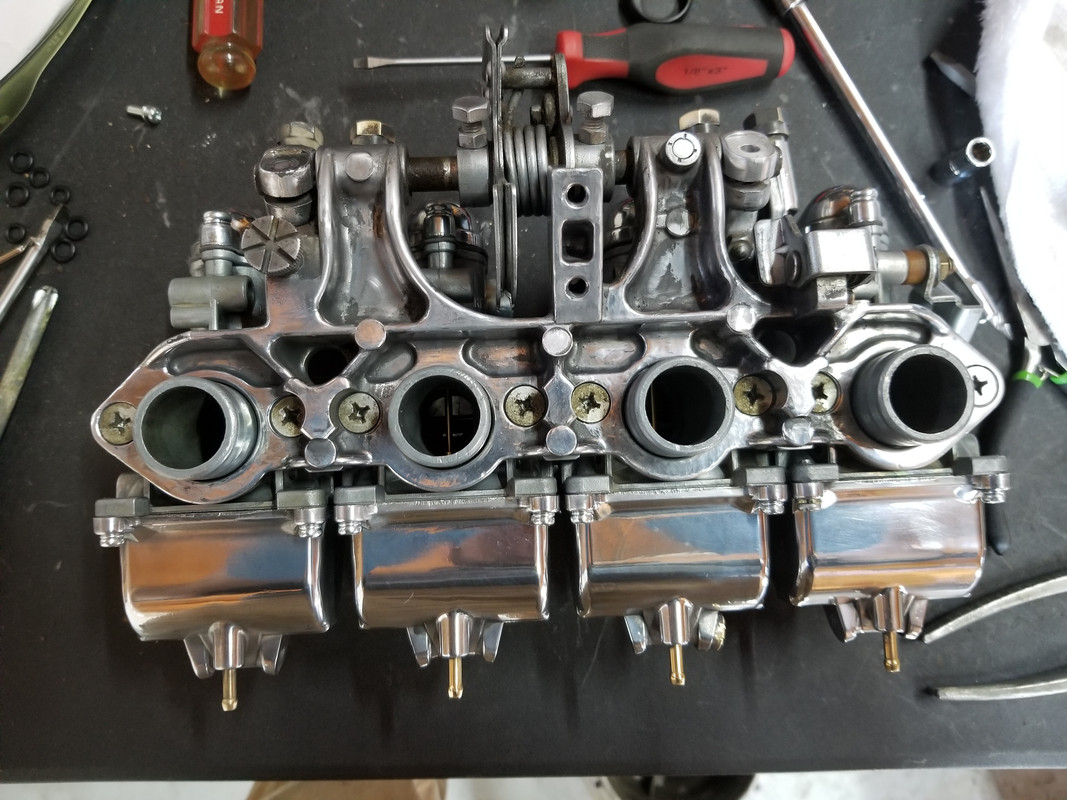

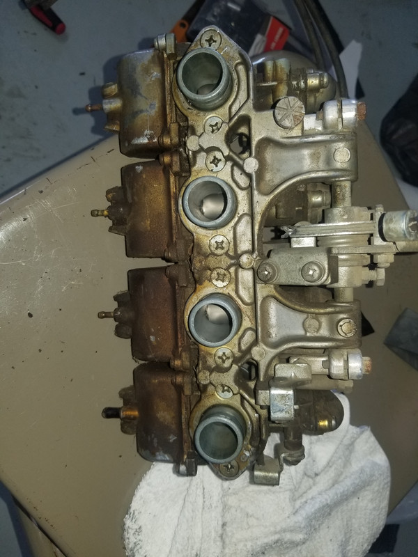

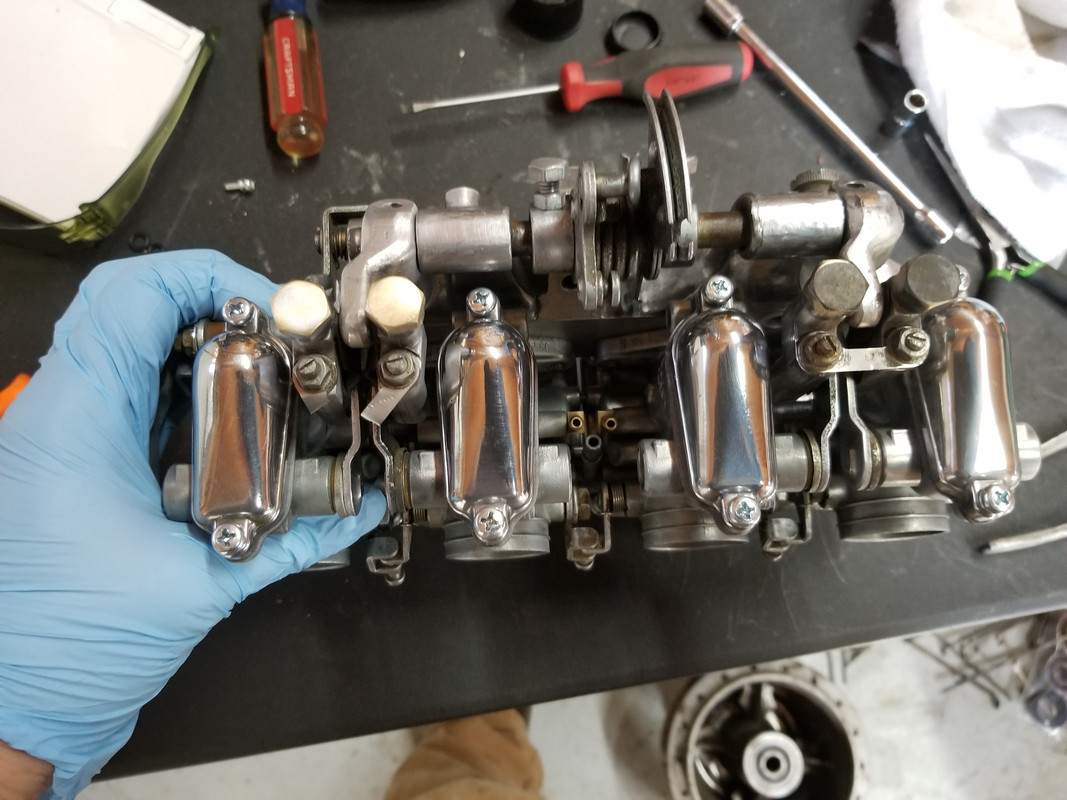

-I decided to start on the carburetors first. I ordered a rebuild kit and some fancy stainless hardware for the bowls from 4into1.com. Simple Green, toothbrush, dremel, lots of elbow grease, and a Harbor Freight bench buffer are must have tools to restore old aluminum to a better than factory finish. The old Honda clear coat that covered the aluminum was pretty well shot, I decided to just polish the bowls and top covers to bring some luster to the old girl.

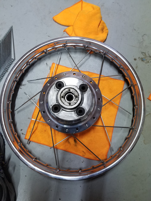

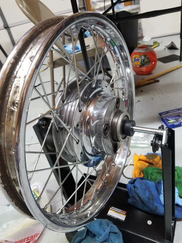

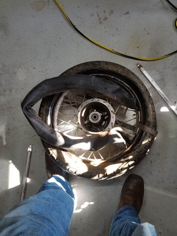

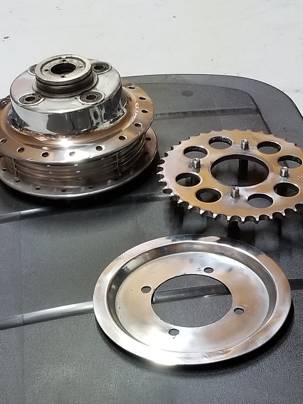

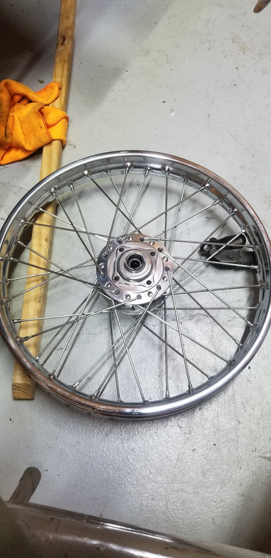

With the carb's completed. I moved too the rear wheel. Since the spokes were rusted out, I went ahead and ordered a new front and rear set from 4into1.com. I was smart enough to remember to take a few photo's of the wheel before removing the spokes. Several family members of mine warned me about removing all the spokes at once, and how much of a pain it is to re-lace and true the wheel. After 4 attempts, a few f words, and some thrown spoke wrenches.... I got the replacing part down. (After polishing the rear hub and rim)
I spent most of the past weekend working on truing the wheel. It took a while, but finally got it running true within the 1/16 in spec.

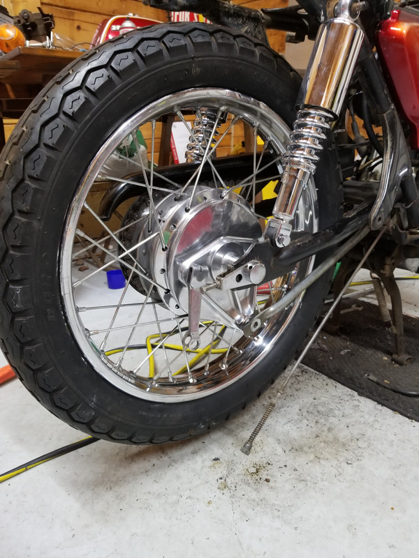

Now i'm waiting on a new tube and rear tire to come in from Amazon before finishing up the rear end. So yesterday i moved to getting the engine in order. I removed it from the frame and gave it a Simple Green scrub down. Polished the drive sprocket cover, clutch cover, and rocker arm cover.
Waiting on a few gaskets to come in before finishing the engine and placing back into frame. Hope to get started on the front portion this weekend and rebuild and polish the front forks, front wheel, and handlebars......

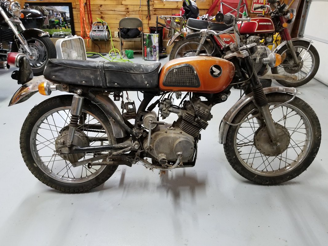

More to come, I have two more classics on deck waiting  (68' CL175 / 75' GL1000) cooldude

Not to many buffing wheels, but have gone through a lot of scotch bright buffing discs

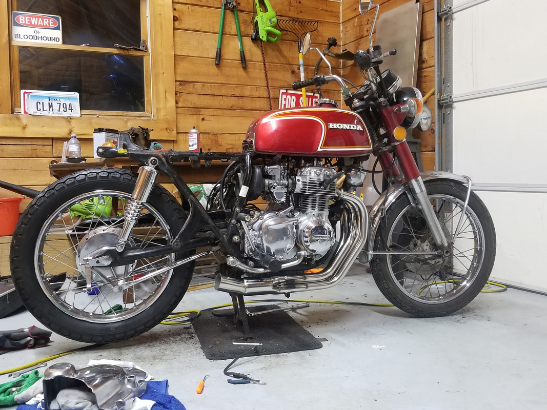

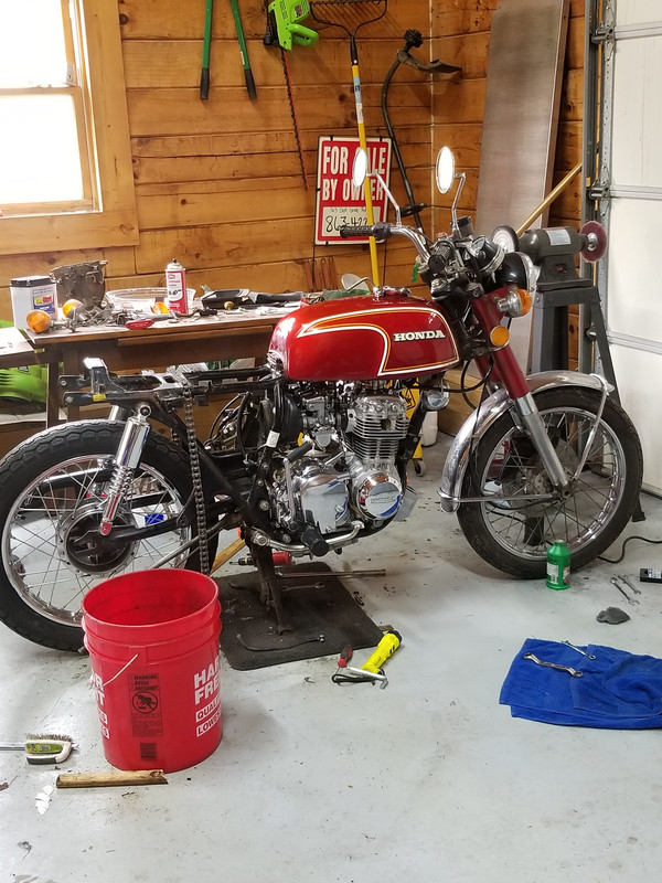

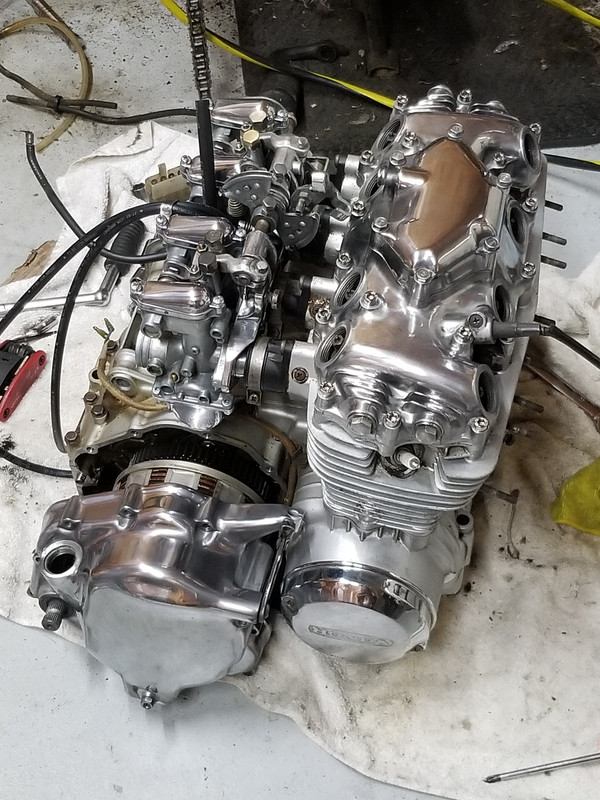

« Reply #22 on: March 20, 2020, 08:59:14 AM »

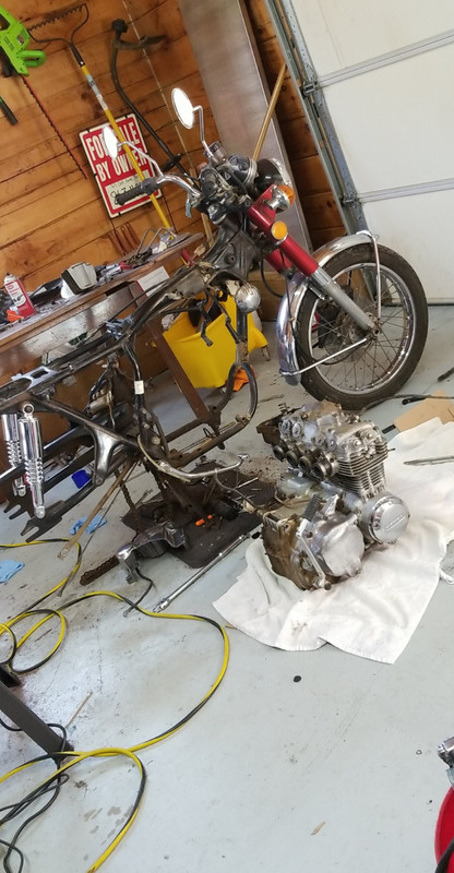

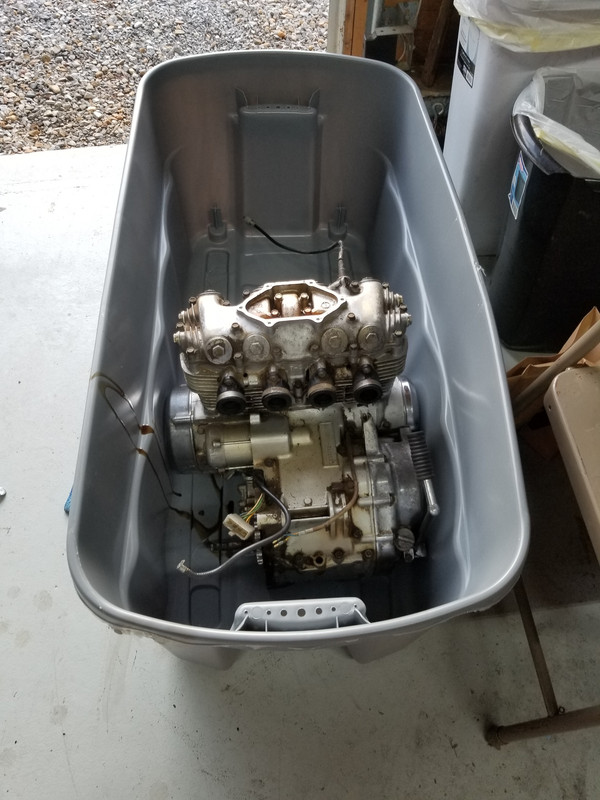

Rear wheel and chain installed, along with the engine back in the frame.
the before and after of extensive aluminum cleaning and polish
I ordered a Delkevic 4 into 1 header system. I haven't decided on a muffler type just yet. I may run it open for now just to annoy the hell out of the neighbors.
I decided to take yesterday off from work since the weather was reaching mid 70 degree temps, with the focus of hearing it run finally. I ran into a no spark issue and spent a majority of the afternoon with the voltmeter tracking down the problem. Finally found the kill switch was not making contact, I sprayed the hell out of it with contact cleaner and still nothing. Decided to just bypass the connection. After that it fired right up.
I have some throttle, choke, high idle, and carburetor tuning to finish up on, but it's at least it's ALIVE!
https://www.youtube.com/watch?v=8MizkFcygS8&feature=youtu.be

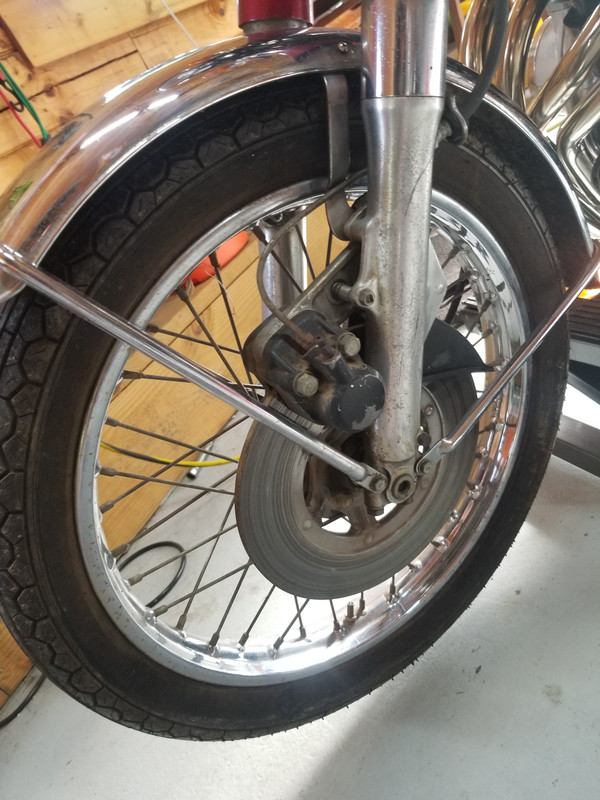

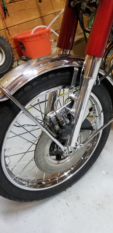

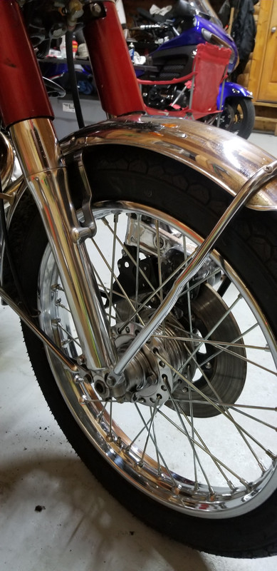

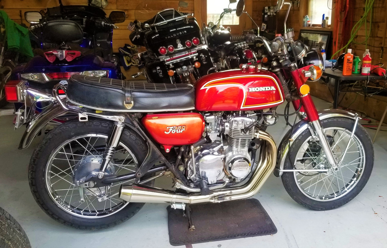

Front end completed. Polished forks, new fork seals, new steering stem bearings, new brake fluid, new spokes.
At this point I call it pretty much completed. I have some new turn signals and missing hardware coming in this week to button the remaining touches up. It won't win any races, but sure is a ball of fun to ride around.
The Before and After
