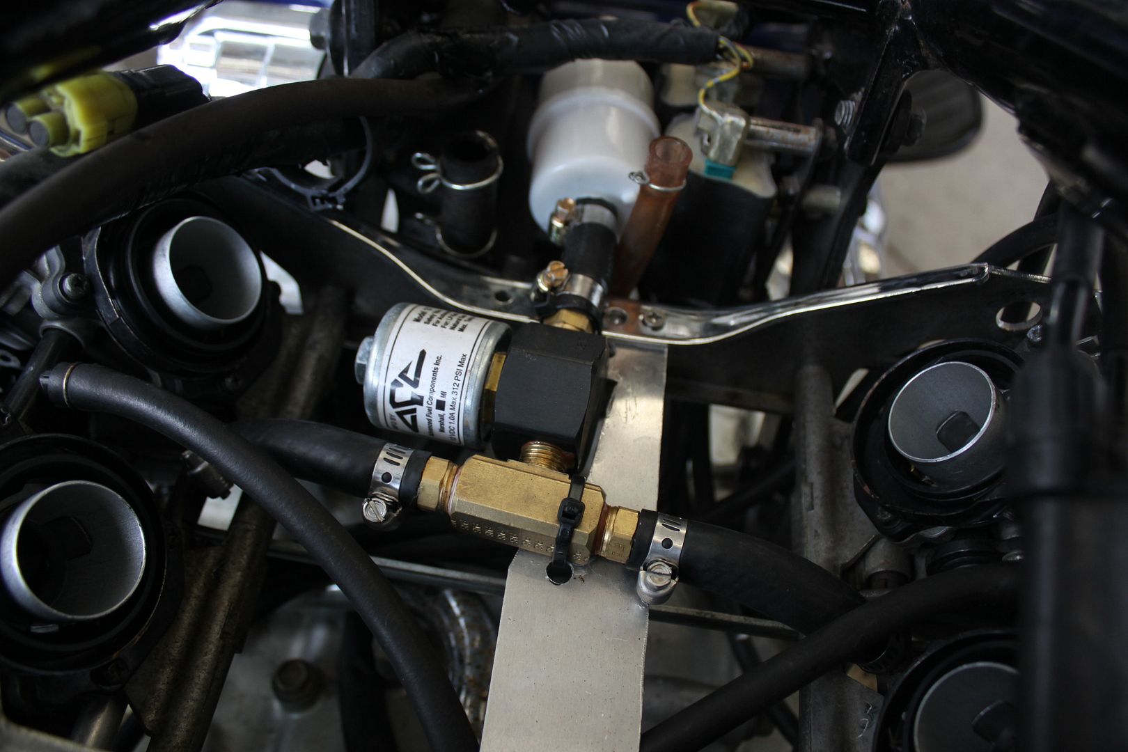

No room between the petcock and T due to the solenoid.
Anybody install 2 filters after the T??
Maybe us some tiny ones?

the one in the tank is perfect. adding a filter reduces flow on a gravity feed system which also relies on the head pressure in the tank. u don't want to go lean at WOT or under heavy load esp when the tank has a low fuel level.

Don't add a filter.  I found out the hard way.

My belly tank has two with fine brass screens, one on the pump inlet one inline by the carbs. When I replaced them after 50-60k I took them apart and there was almost no sign of dirt.
The intank filter should be more than up to the task of keep dirt out of your carbs.
So did I. Even using a fairly large, 3/8" filter between the Pingel and the T, I ran into vapor lock issues during high speed riding in high ambient temperatures (roughly 110* heading down the highway at 85 into Las Vegas last year). It'd start dropping cylinders and act like it's running out of gas, despite having plenty of fuel. Slow down, and it'd run OK, but I couldn't go over about 55 that afternoon without it running like crap.
It was fine beforehand, and after, but it also wasn't that hot again. I tossed the filter, and the problem has not returned since, even in similar hot/fast riding conditions.
One of those things that "seems" like a good idea, but tends to cause more issues than it solves.

My '03 had a filter on it when I bought it in '16 so when It starting dying at high speeds I replaced the filter. Some problem, and the bike has to cool down before it will restart. I can understand the filter starving the carbs at high speed, but why won't it restart right away or shortly after?
I doubt it was the filter itself.  If the fuel line is continuously downhill it has a tendency (accelerated by heat) to develop a bubble, an air block.  Adding a filter too often involves adding fuel line which results is some slight uphill portion.
