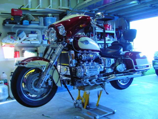

From Color-Rite, this is whats on mine. I painted my faring with it. I matched the pin stripe and painted it also,then clearcoat.
R223  Pearl Sedona Red  Red/Cream Two-Tone     2900
Y137M  Pearl Ivory Cream  Red/Cream Two-Tone     2915    1915 clear coat

6Jugzz, That is a mighty pretty piece of iron that you have sitting up on that stand.   Congratulations on such nice work...JTL

Thanks for the comp., and you are right,the guy that painted mine had to use some special primer for abs palstic before final paint. The friggin paint cost $275 for three half pints (two color,1 clear). I got about $850 total in mine ($550 in paint) and its been on for three yrs and I love it. The Klocks-Werks windshield is worth every penny,the best money I've spent to keep the bugs off my teeth. cooldude
