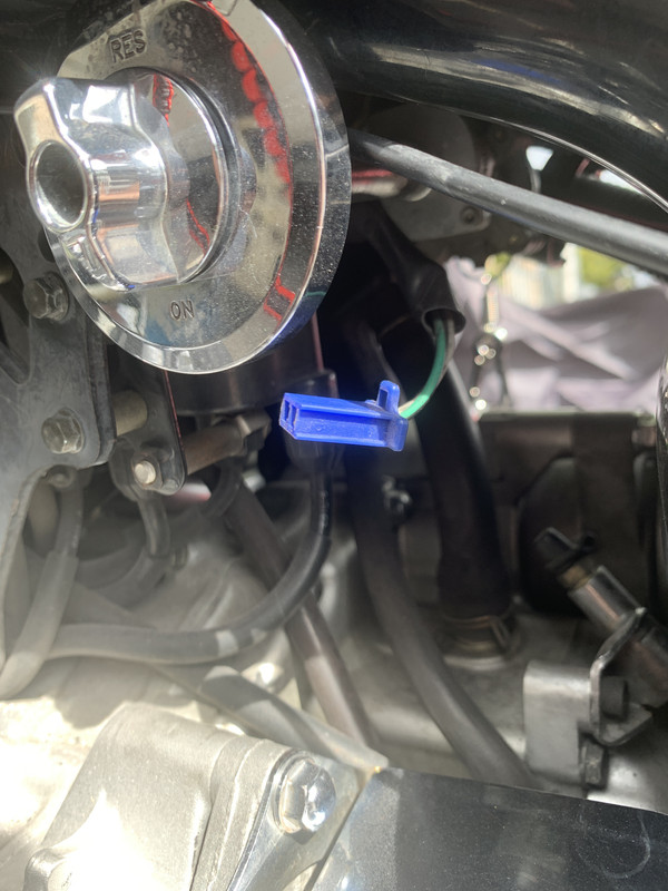

Hello fellow riders, after receiving my 2000 Interstate back from the shop upgrading audio my fuel gauge keeps saying empty even when full.  I think this has something to do with it but i do not see where this plugs into if anyone can help? should hopefully be something i can reach without too many tools or removing things i hope. . .

Raise the tank up till you can see the blue receiving end that the plug shown in the pic will connect with. It's kind of buried under a plastic cone.
Make sure you connect the fuel line, vent line and vacuum line also.
Bob

And make sure to remove the inner petcock screw b4 u lift the tank!   A block of 2x4 will help,  and maybe a headlamp  and long needle noses.

  My brother my suggestion to you is go for a long ride and get that near 7 gallons
of gas out of the tank the fun way.
  Then disconnect the gas valve and like was said lift rear of tank and with a good
flash light you will see where it will go.
  Plus look what you will learn and you will have a Zinn moment with your ride.
