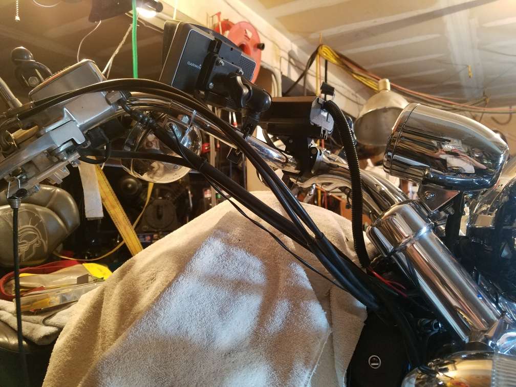

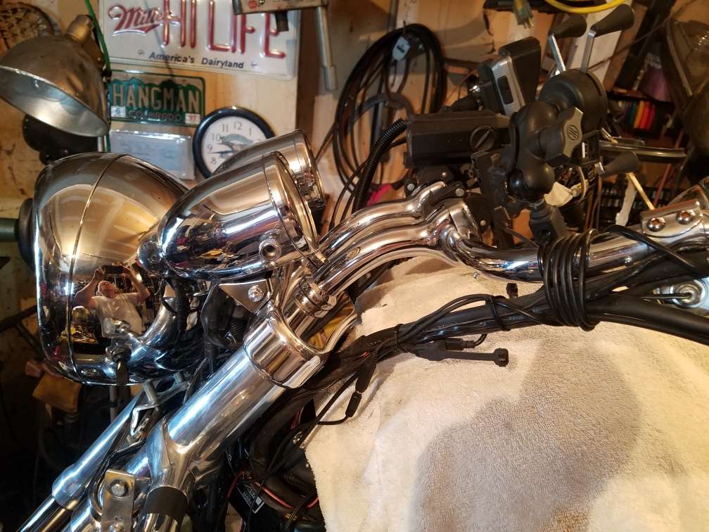

Just completing fork rebuild, polishing, VTXextreme 4° triple trees, Progressive springs install, shield and it's hardware which have wire and cable holders, not on yet.  These are my 9" Harley risers.  I routed the throttle cables behind the trees some time ago; no other routing or length changes.  With the bars further back and turned down to straighten my wrists, (and other changes - highway pegs, forward controls, Russell seat, Rostra cruise and Brakeaway lock) this bike is far more comfortable than my wing.  Yeah lotsa toys on the bars - ZUMO, trailer brake control, Escort, Phone X-mount, Rostra cruise panel, fuel control panel, Brakeaway throttle lock, speakers, Butler drinkholder, paper cup drinkholder, ball mount for Hero camera, XM satellite antenna.  Pardon the clutter, still in process.
