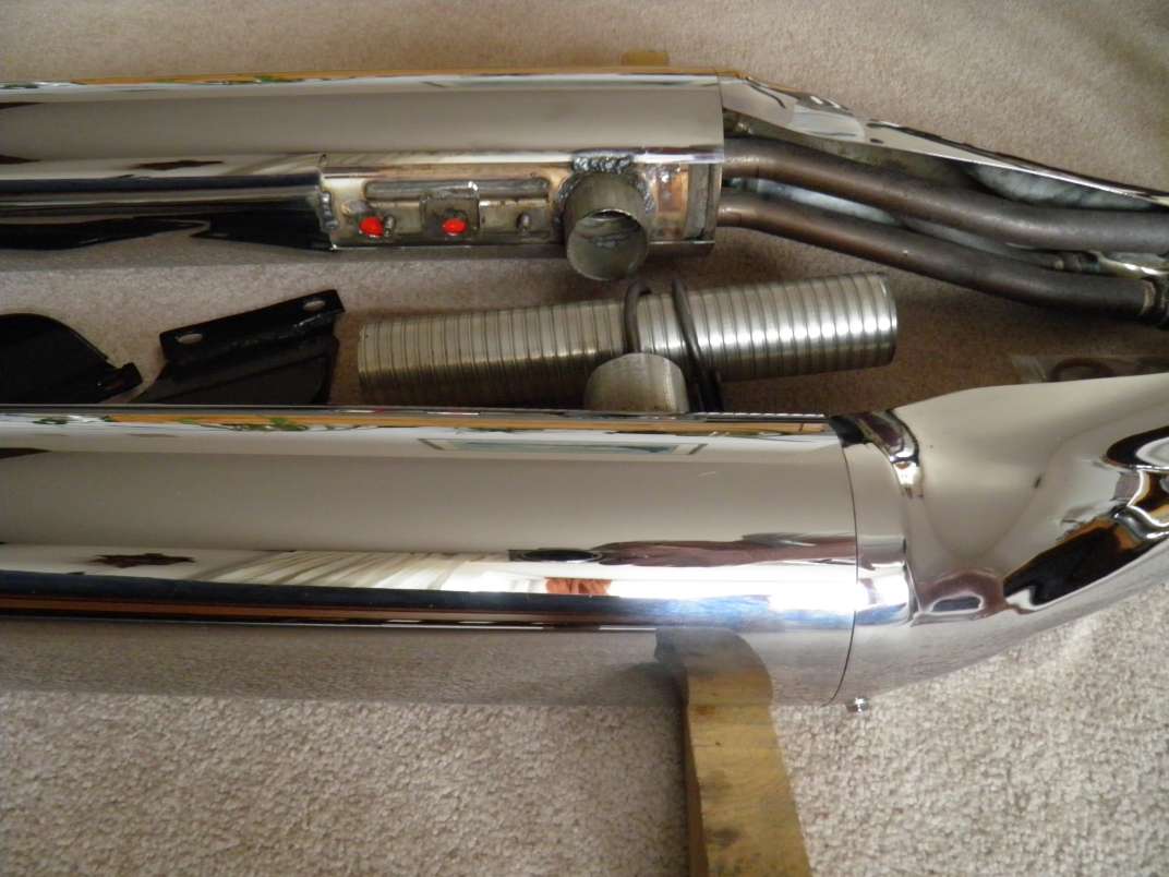

You can safely cut airflow stacks since they are Dynaflex and I've never seen bad chrome from them.  You could take one 36" flat-cut and cut it in 2 then drill the holes on the unchromed-edge end so the cut edge is forward while the chrome edge is the visible one.  2 things - be sure it's cut absolutely square so use a quality saw that holds square between the fence and blade, like a bandsaw.  NOT A CHEAP SAW LIKE HARBOR FREIGHT.  I use Milwaukee chop saws with very ridged abrasive blades, reinforced for cutting concrete - called Walter Portacut blades.  HF blades and other brands too are very flexy and won't cut straight.  Use a carpenter's square to make the fence exactly square to the blade.  Put a fresh microfiber rag on the fence and table to prevent scratching the chrome. Just recently I picked up a 14" carbide saw for cutting stainless and it doesn't flex.  Just used it on one of my Milwaukee chop saws to cut the 5" stacks on the build that is waiting for Fedex.  BTW this type of blade leaves less cleanup of a burr compared to abrasive which actually melts its way through a cut.  Also when you cut it, stop before you go through the backside.  Rotate the stack and finish the cut.  If you don't get the 2nd cut exactly right you can still save it by feathering the cut with an appropriate grinder.  That never happens with me anymore; I make sure the 2nd cut is correct so as not to have to save it.  "Measure twice, cut once."  And verify you aren't goofing BEFORE you cut. I remove the "sprue" (burr) on the inside with a carbide burr in a die grinder.  The burr on the outside I remove with a 1" highspeed belt sander, sanding just the edge, not into the chrome face at all.  My tricks.  If you don't have such tools and the skill/practice using them, it's easy to mess up the chrome.  I use towels and freshly washed microfiber rags to prevent scratching when working on finished chrome.  The headers are wrapped with carpeting so I don't add blems.  Take care not to overheat the chrome, if you do it will color.  I use cooling sprays when I need to grind or sand on say the edge of a chrome piece, or do a grind then dip it in a bath then resume.
Here's the pipes I mentioned above.  Note how nice the crack is where I cut it.  Not to mention the nice fit of the recontoured to 5" diameter OEM cover.
