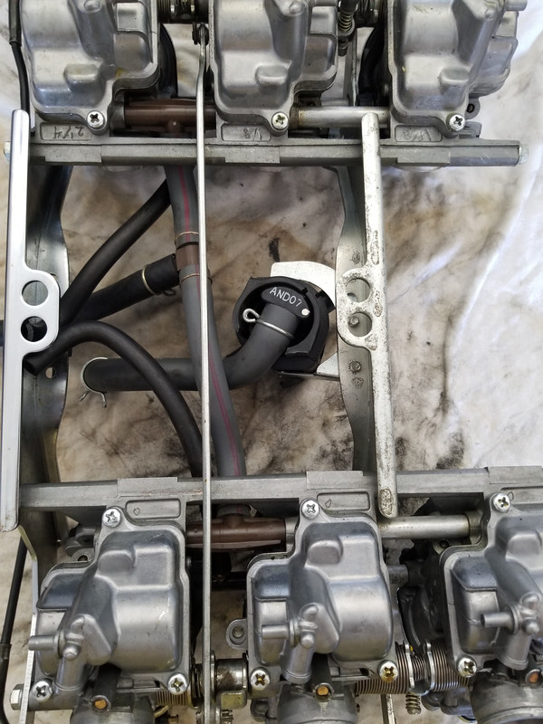

  The two hoses that come out of the 3way air joints in the carbs are supposed to run back to a T and then back to the Airbox, correct?
[/quote]
those 2 air hoses turn and go thru the 2 holes in the chrome end bracket. They are open and do not connect to anything. This pic shows the holes but the hoses aren't in place as they should be.
