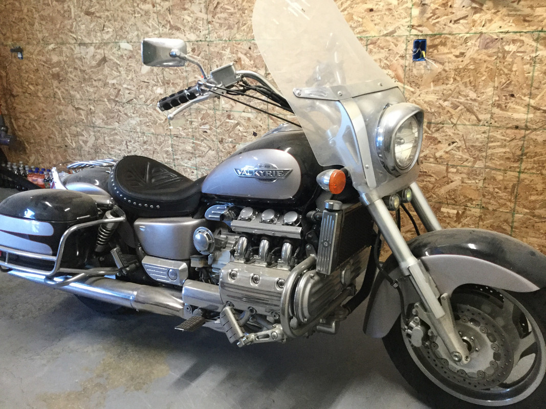

A lot of Valkyries out there now 20 plus years old and whether mucho miles or low miles they all need maintenance and updates. Mine in particular has 53,000 one owner miles but hasn’t been ridden since 2014 so you can imagine all the things that will need to be done to get it road worthy.
I could use any and all links and info about good vendors to source repair parts for all systems as I want to give the Valkyrie a stem to stern going over. My first ten years of ownership I rode a lot more and did all my own maintenance, read all I could about our bikes but of course with the built in reliability of Honda, I never had to go too deep. I’ve gotten a little rusty so to speak on my skill set so I may be calling for a lot of help.
