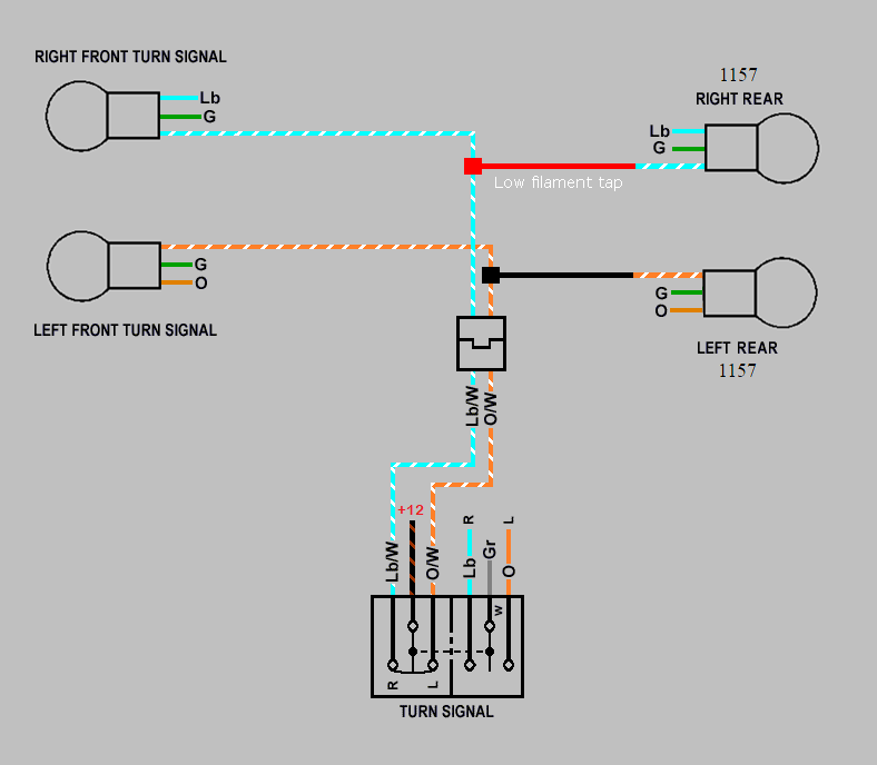

End result is I have 4 lights that will blink but only running lights on the left side not on the right side. PO did make the back lights running lights
My theory is that the tap for the Right side running light severed the donor +12 wire (below, red rectangle). I'm presuming the PO installed 1157 dual filament sockets in the rear signals. Also, the PO powered the rear signals' low filaments by taping into the front signals' running light wires.
This won't explain why the idiot light stays steady ON, though, beyond a coincidence. The idiot light monitors the presence of voltage on the signals' hi-filament wires.  The voltage on the hi-filament wire are pulses (blinks). The idiot light mimics the blinks on the hi-filament wire. If the idiot light is steady ON as we speak a wire must be feeding the hi-filament wire a steady +12 voltage.
Conversely, if the idiot light stays lit the hi-filament in the signal has to have some voltage running through it. If you remove the lens, is the hi-filament always dimly lit?

« Reply #9 on: April 06, 2020, 09:41:41 AM »
Good simplified drawing. The turn indicator would be between the LB and O wires, if the wiring is otherwise stock.
If the right signals lost ground, power would go through the bulbs from the running light power to the signal wire, and light the turn indicator when the left side is not blinking; in this condition, you would not get any glow on either signal filament on the right side. If only the rear signal lost its ground, I would expect the front to blink, anyway, but the indicator would still be on steady, except when the other side is flashing; the front would be glowing some, too, but not very bright.

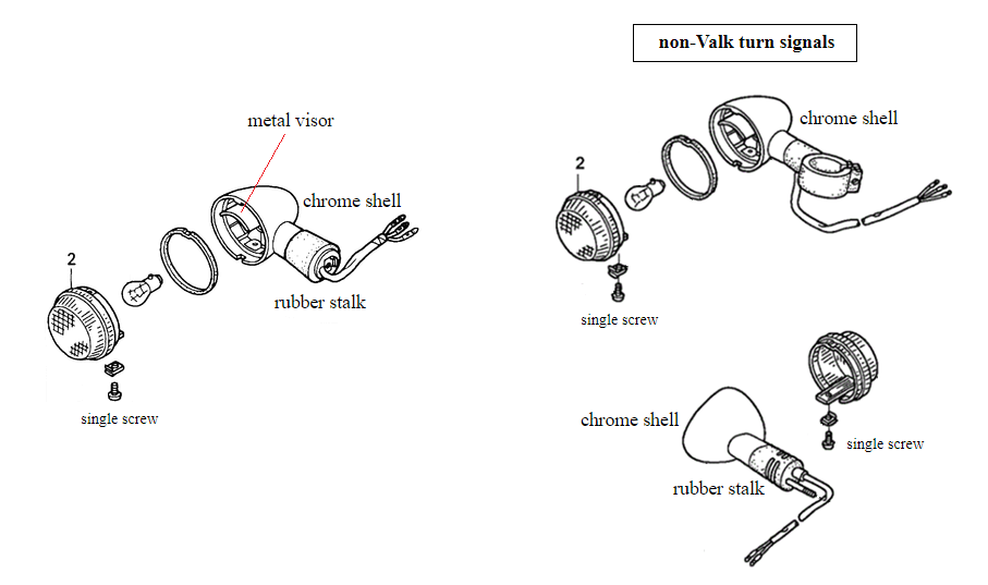

I glued the plastic piece back in and stretched the spring a little so it would good contact. Problem solved.
You can scavenge a chrome shell from a damaged signal sold cheap online. Doesn't have to be a Valk signal. Front signal or rear signal doesn't make a difference. The shells are interchangeable or generic. It just has to be a single-screw turn signal.
You can reuse the metal visor on your old signal. Rear signals don't have the visor & actually not all front signals have them either. The visors slip into channels molded into the shells. To pull the visor out though, one-way teeth takes some persuasion or just smash the shell.

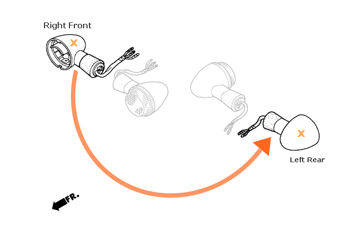

« Reply #16 on: April 25, 2020, 02:22:52 AM »
Minor detail, the chrome shells have a top and bottom orientation, so a left chrome shell is not interchangeable with a right shell. At least this is true for single-screw lens. Also, a front right signal is the same as a left rear signal after its rotated 180°. Bottom pic.

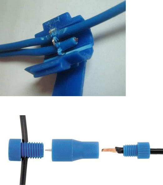

Those wrap around connectors are horrible. Eventually prone to fail either by weakening the wire they cut through or getting oxidized over time.
Those vampire connectors (Scotchloks®) are not recommended for amplifier wiring which are subject to vibrations and motorbike wiring too I guess. Another quick connect option is Posi-taps® (bottom pic). Both are bulky though in tight quarters.
