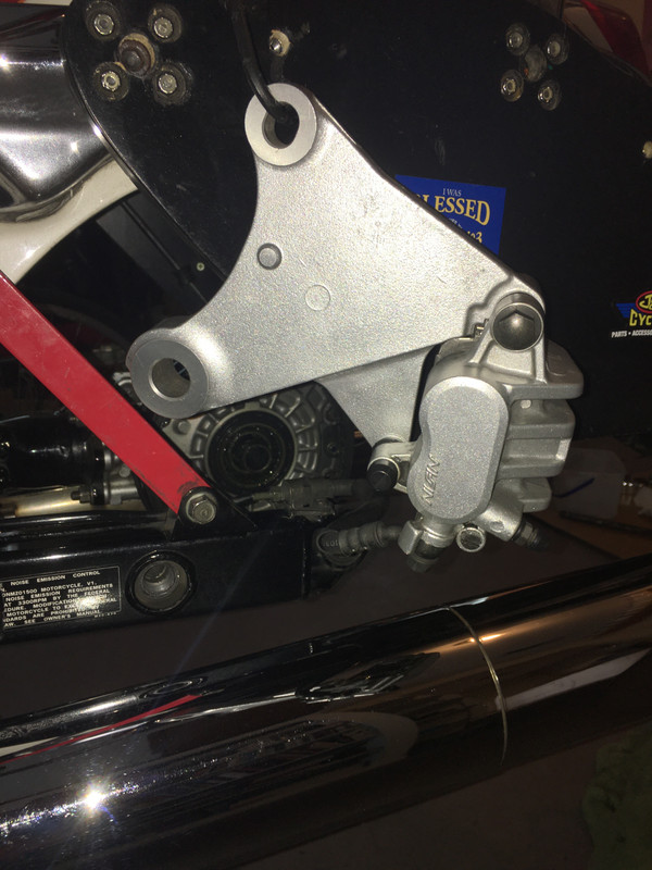

I took the bike out for some “necessary” errands and to test the fixes I had just done. It was a beautiful ride up until I pulled into our neighborhood. I hear this rack rack sound when turning left. So I stop and take off my helmet so I can hear better and ride the rest of the way home. With the slightest lean to the left the rack rack sound returns. I’ve heard this before. Left wheel bearing. I get the bike put up and toss a left rear bearing in the freezer and start getting tools ready.
30 minutes later the wheel is off and what do I see?  A big shiny screw in the left side of the tread just off the flat spot. Good news about not having to do a bearing change but I Hate Flat Tires!!!!!
Well crap nothing open on Mondays so I have all day to get things cleaned up and ready to go back together. I cleaned the dirty nasty rear caliper and caliper plate and also wiped down the inside of the rear fender. Mike, it doesn’t look much different after cleaning it. But I know it’s cleaner. Lol.
I had just had the rear end apart because it had been over 10,000 miles so all my grease looked good. I wiped the usual slung grease off the flange and added a little more to the pumpkin and cleaned it all up.
So, my nice easy ride turned out to be a royal PITA. That tire has 9 or 10 thousand more miles left on it so I will try to get it patched. If I can’t find a shop to patch it, I guess it’s new tire time a bit early. Oh well, there are worse things  Angry
