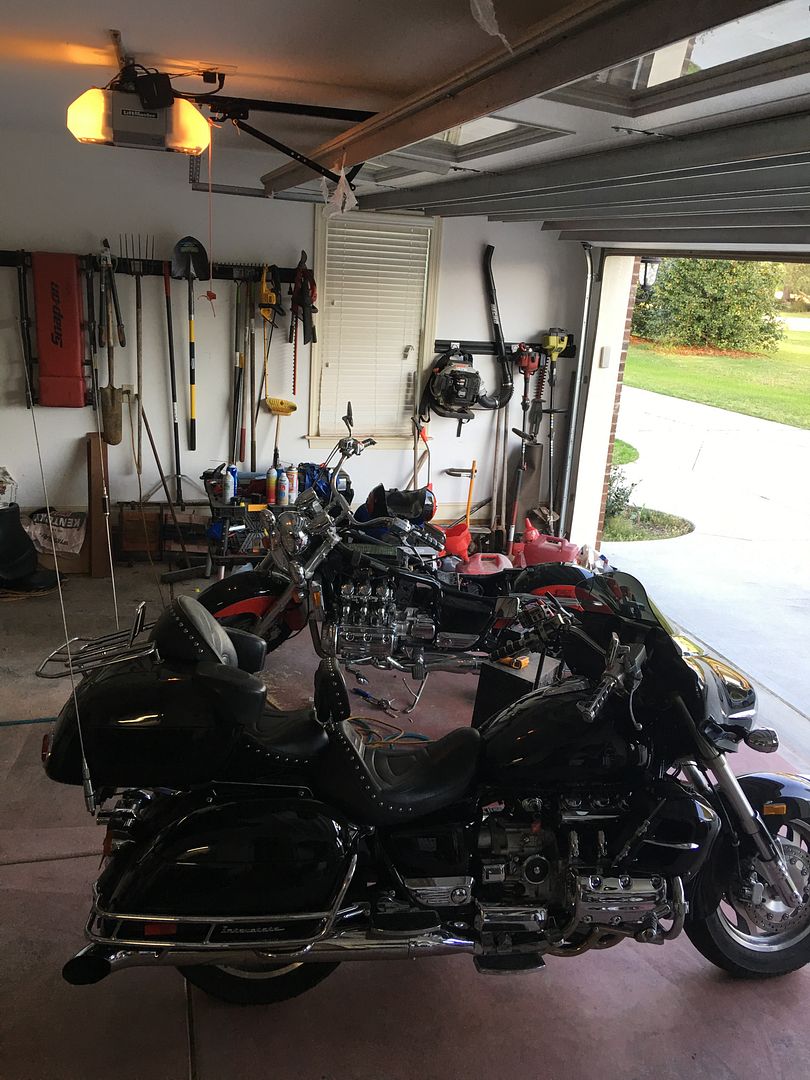

Well, wife is getting pissed about losing her garage while I am "working" from home right now.
So, I got the black IS running and decided to focus on the standard the last couple days.  Got her fired up off the battery jumper, but battery is shot.  Kept running carb cleaner in her and draining the bowls to make sure fuel was making it in properly.  Ran to town and grabbed the new Napa battery and plugs this morning and put it in.  Hit the starter and got the "clunk". Crap.  Really didn't want to pull the carbs and was hoping to get everything running again without it, but guess things are changing now.  So, Pulled the plugs, rolled her out of the garage, hit the starter and EPA now coming to get me for that huge gas cloud!  Three cylinders blew gas.  I guess it is time to clean up the table from the last carbs and start ordering parts.  This one has never been desmogged and is still all factory, so while she is apart I guess it will be time to do it up right.
