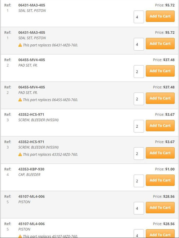

06455-MV4-405 is a replacement for 06455-MZ0-760 (and 06435-MZ0-006 replaces 06435-MZ0-760). Also note that the rear pads are the same as the front, with slightly thicker linings on the rear.
Screenshot from hondadirectline.com:
