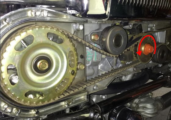

Are you sure all teeth are seated in their notches and the belt is routed like this pic?

Yes, went riding a few times it's just I know it's tight because it's making noise. The left belt as play but the right is still a bit tight.
