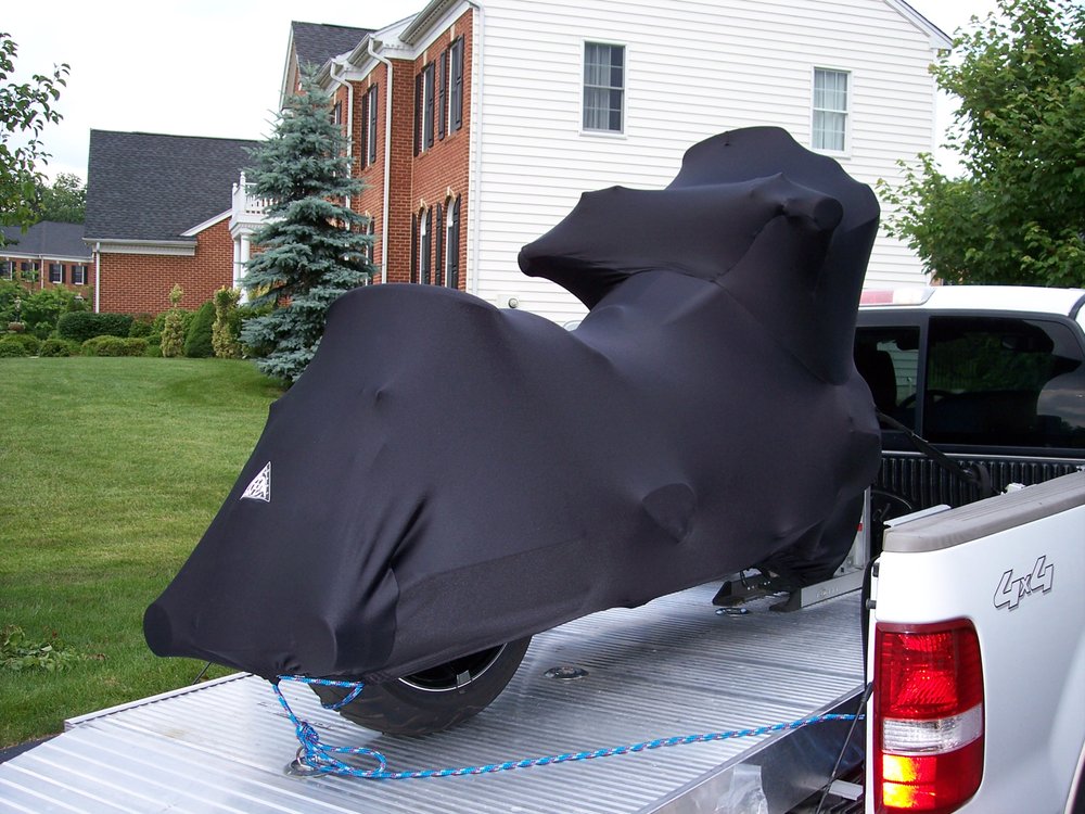

Now this company is in my county, and they sell (expensive) unique, tight stretchy ones, but I've never seen one or read any opinions.  But they look interesting.  http://www.gezagear.com/
More like a condom than a cover (but without the lube).  Smiley
