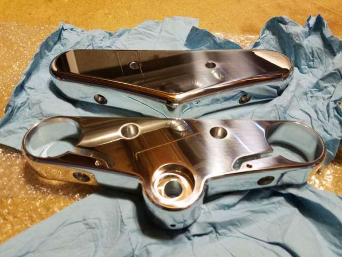

I just finished a rebuild of my forks, with all new wear parts, Bel-Ray 10wt, new Progressive springs, VTXtreme 4° triple trees, and polished all the aluminum parts and light mounts.  Used the Honda shop manual, the Clymer shop manual, and Wood Butcher's tech file on the seal replacement over at Southern Valkyrie Riders FB page.  ( linked at https://www.facebook.com/groups/642576109419780/files/ )  BTW there's an error in the sequence on the assembly, right side insert the spring collar AFTER the oil and the spring, not before - do it in the sequence listed and you'll be draining the oil back out, taking the collar back out and doing it later.  I haven't told him of this correction; he has bigger family issues right now.  Also it's really good to have a couple manuals for reference; I needed them both to get a good understanding.  This is an involved job.
OK so what I concluded is, the Progressive springs deliver a more harsh ride than the OEMs.  Which I had the dealer install on Deerslayer almost 20 years ago, and got a soft ride and less dive.  Talked to Bob Smith - he said the same thing - harsh ride - and so doesn't recommend Progressive front springs anymore.  Now take what I just said with a grain of salt.  Because I violated the "scientific method".  I changed several things at once.  And who knows if the springs are the same as 20 years ago.  Or if they were changed deliberately, or the springs are now "unobtainium" so they substituted something else and "forgot" to tell me, or some clerk just screwed up and shipped the wrong springs.  Not to mention, I could have got slightly too much oil in, though I was pretty careful.  Didn't realize a difference of say 1/4 oz matters much.  That could be it too.  And even Bob aka Attic Rat might have made the same mistake.  I mean after all, if a little is good, "a bit more is better" right?  It's surprising to me that considering the volume of oil in there (Clymer spec, Rt 22.52-22.68 US oz, Lft 24.72-24.88 oz) that a small amount over would destroy the ride.  And my oil was not measured with a laboratory graduated measure but a kitchen measuring cup.  They do specify, measure the depth and suck out any extra which I did.  But again, not until after being done and unhappy with the ride, and even reading this, am I more aware of the specificity precision importance.  I might get a wild hair and see if I can lower it slightly though the effort does not motivate me much.
BTW the handling is better with the VTXtreme 4° trees, and the look is WAY better with all the polishing I did, in addfition to Daryl's beautiful polish on the trees.  Though that's harder to see with the shield blocking up the view. I was going to clear powder coat the works but did one fork and was disappointed with the result so I stripped it back off, repolished and then put a good coat of Mother's on the works.  It was quite a bit of time to do the job, though I'm not complaining, after all it's quality time with my baby.

I'm using Bel-Ray 10wt Fork Oil as recommended by Daryl at VTXtreme Triple Trees.  He has many years of experience on these forks, these bikes and the custom angle trees so I deferred to his expertise.  But I'll bounce this off him.  And this is also Bob Smith's opinion - harsh Progressive springs. Probably one of the best Valkyrie gearheads there is.  And again, I had too many variables at once.  As I said before I'll likely get a wild hair and make adjustments, likely to the fluid.  This harsh ride will grate on me since I know it can and should, and used to be, better.

I have over 60,000 miles using Daryl's 4 degree Triple Trees and Hyperpro front springs with 7wt Fork Oil.
I have just changed the oil for the third time, oil at rebuild with Hyperpro, again at 30,000 and just lately at 60,000.
Comes off the kickstand easily, rides nice, and steers like it has power steering.
