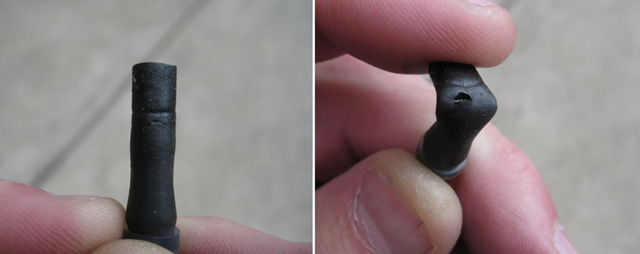

Both oem and redeye vacuum caps are good. I posed a question on removing the nipple and replacing it with a bolt.
This was another forum member's pic. The vacuum caps can develop hairline fissures. I think that's due to bumping the vacuum caps when cleaning under there.
