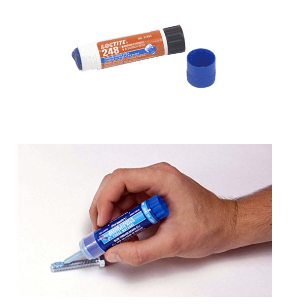

« Reply #7 on: May 03, 2020, 04:24:13 PM »
But don't you only us a drop on the item? Would this then may/may not coat the whole length of the threaded section?
If you're still using the liquidy locktite, it's hard to keep a 'drop' from running the entire threaded length of a bolt. As Pluggy stated, the gel version works better. Less waste. No drips all over the place. I haven't tried the 'chap stick' dispenser yet. They weren't around when I bought my last tube of locktite. But gel in the tube dispenser that I use is good too. If I went with the chapstick dispenser, I'd prefer the one with the spout (bottom pic).

« Reply #8 on: May 03, 2020, 04:39:52 PM »
Hey, Ron.  Nice pics.  A little stripe of that "chap stick" blue stays on the bolt until you install it.  Easy to use while working on your back under the old truck.  I still use anti-seize, and it is a must on old bikes where the fork tubes screw into an aluminum casting.   Of course, that's not a fastener.  On fasteners, it is Loctite, most often the low-strength blue.
