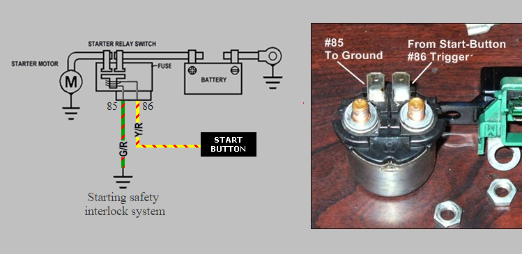

« Reply #30 on: May 05, 2020, 12:53:59 AM »
Usually the top connection is the one that burns and melts, not this time though .  Now what I swapped was just the bottom part of the selenoid not the top red cap.
The wire for the internal electromagnet might be severed. The two prongs that stick out of the starter relay are opposite ends of the same wire that forms the electromagnet coil (right pic). You might try testing the electromagnet's wire for continuity. If the wire is severed the electromagnet can't close the starter relay switch. If you apply current on the two prongs and hear a click sound than the switch is closing and obviously the coil wire is intact.

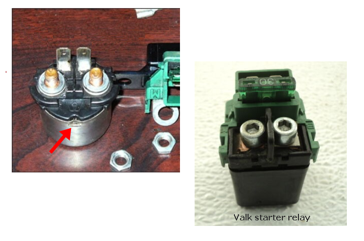

I bought a cheap one on Amazon that said it for the valk.  It is wired differently than the OEM relay and does not work.
« Last Edit: May 05, 2020, 05:42:33 AM by Skinhead » Logged
Posts: 15322
« Reply #32 on: May 05, 2020, 08:57:22 PM »
Years ago we used to have problems with starter solenoids that mounted on top of the starter motor. The two large external posts which you connected your cables to had contacts internally. When the internal "plunger" would smack against those poles on the inside the starter motor would run....the same as though you laid a screwdriver across those large posts. Over time(years), the plunger would flatten out the posts internally where it contacted them and eventually you had a solenoid that wouldn't cause the starter to run because the plunger no longer was making contact. You could go buy a new solenoid and it would cure the problem for about the same period of time it took the old one to fail. Or...take the solenoid apart, loosen the flattened posts and turn them 180 degrees, put it all back together and you were good for a bunch more years...and not out any money. You could do this because the plunger didn't smack the entire surface of the posts, it was usually round or oblong and only hit the inside area of those posts internally. By turning them around you exposed the plunger to new and unflattened surfaces again.
Yeah...I'm full of all kinds of useless info from days gone by.  Wink  However, that may well be part of the problem with Larue's bike but don't think you can take these apart now.

« Reply #33 on: May 05, 2020, 10:46:42 PM »
[the plunger] may well be part of the problem with Larue's bike
  • but don't think you can take these apart now.
On the round relays, you can straighten the crimps and pull the can off the relay (red arrow). With square shaped relays, the plastic layer has to be removed to get to the crimp (I think).
