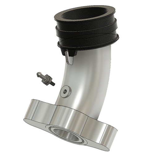

As meathead, et al. said, disconnect fuel selector (7). This allows you to tilt up the aft end of the fuel tank and remove (1) and (28) the best you can.
Vacuum tube (5) is disconnected from the Right side of the bike. *The following is theoretical not per manual. On install, you have to use pliers to connect vacuum tube (5) back to its spout which to me damages the vacuum tube's rubber little by little. So, I prefer to disconnect the vacuum tube at its bottom end where the vacuum tube can be slipped back on by hand.
The bottom end of the vacuum tube plugs into chrome intake runner No. 6 which is the rear most intake runner on the Left side of the bike. However, I switched it over to intake runner No. 5. which is the rear most intake runner but on the Right side of the bike. It's easier to fish the vacuum tube down to No. 5 runner when reinstalling the fuel tank than it is to fish the vacuum tube down to the No. 6 runner.
I suggest you don't pry up the aft end of the fuel tank more than is necessary or jerk the tank around. Lifting the fuel tank pulls fuel hose No. 15 along with it before No. 15 is disconnected.
No. 15 is connected to a t-fitting (red arrows, bottom pic.). The branches of the t-fitting are connected to the fuel rails at X, below. Thusly, you end up putting stress the fuel rail's o-ring joints if you pry up the fuel tank too high while No. 15 is still tethered to the fuel tank. In the inset photo, you can see my fuel rails are damp. The telltale sign of a fuel leak. (True, the cause of the leak is debatable.)
