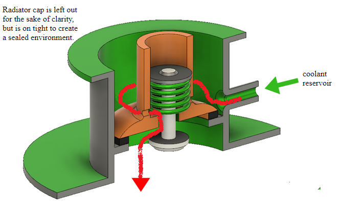

When I went to refill the over flow container I had an impossible time getting it to flow to the radiator.
Just fyi, it's easier if you fill the radiator and the overflow tank separately. There's a tube connecting them, but the tube wasn't meant for filling coolant. If you ever taken a oil filter apart, there's two valves in there ..... an anti siphon valve and a bypass valve which aren't visible. The radiator cap also has two valves in it which aren't obvious. True, the radiator cap is removed to fill the radiator but never mind that for now. It's just that the radiator cap regulates the direction that the coolant flows in the tube and the only way that you can get coolant to flow from the overflow tank uphill to the radiator.
There's a pressure relief valve (orange thingie) built in the radiator cap. Spring loaded at 16 psi.
When coolant heats up in the radiator, pressure builds up. The pressure relief valve opens at 16 psi and the pressurized coolant flows to the overflow tank (or coolant reservoir).
A vacuum relief valve is housed in the pressure relief valve. Like the pressure relief valve, the vacuum relief valve is a one-way valve but it opens in the reverse direction.
When the engine is turned off, coolant in the radiator cools and shrinks in volume creating a vacuum that opens the vacuum relief valve.
This allows atmospheric pressure exerted on the coolant in the overflow tank to push coolant to the radiator replenishing the coolant supply. Or, the vacuum in the radiator siphons coolant from the reservoir tank. You can't get coolant to flow from the overflow tank to the radiator otherwise. The tube that connects the overflow tank to the radiator is labeled a siphon tube in the manual.
