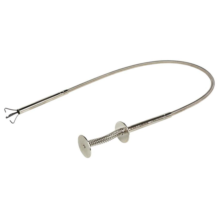

Would this work?
https://www.lowes.com/pd/CRAFTSMAN-Automotive-Pickup-Tool/1000594933?cm_mmc=shp-_-c-_-prd-_-tol-_-google-_-lia-_--_-mechanicstools-_-1000594933-_-0&store_code=715&placeholder=null&gclid=EAIaIQobChMIh9XLv7S36QIVh6_ICh33Xwj4EAQYByABEgI7-fD_BwE&gclsrc=aw.ds

thanks Jess, I'm gonna give that a try!

Studlly, that flexible grabber may not have wide enough jaws (full open) to grab the screen.  You can't tell from the picture if that's as wide as they get.  The screen itself is so tight, I don't think the jaws will pierce  it or get a good purchase, unless it bends inward some.
it's a 98 standard, I'm just gonna get a new screen, screw it, spent a couple hours trying to get it out with the grabby thing, no luck. thanks guys for taking the time to help, greatly appreciate it  angel

I just went through the exact same thing on my standard.  I probably spent 5 hours one day and a couple hour another trying to get the damn thing out.  Filled not with water so see if it would float since water is heavier than gas, and it will not.  Tried shaking it a million different ways to get it out the top, no luck at all.  Damn filler neck blocks everything.  Then there is that little bar forward of the filler neck that keeps you from being able to get it all the way to the front to grab it.  Tried the little flexible grabber, coat hanger with gorilla tape, small vacuum tube, over and over, no luck.  Finally just left it in there, put another screen on the petcock and went on about riding.  This was a couple months ago.  No problems.
