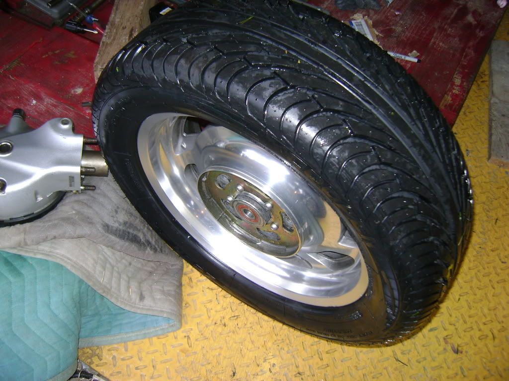

205/60/R16 Kelly Springfield Fierce
Needed nut cage modification

« Reply #32 on: December 30, 2009, 06:51:50 AM »
 Smiley A lot good information - thanks for the input
I'm leaning towards the Goodyear Triple Thread 205/60/16 mostly because it seemed to be the most popular choice among VRCC members who responded.  Since I would be new to the Dark Side I thought it would be best to get my feet wet with a tire that has had the most good reviews.  Grin
Mounting and balancing - seems to me that I herd some bike shops shy away from mounting car tires - I did see that some where able to get their local bike dealer to mount - have not aproached my local dealer yet  Roll Eyes
In case local bike shop refuses to mount - how have others managed to get tire mounted ?  coolsmiley

« Reply #39 on: January 29, 2010, 12:24:57 PM »
The rear wheel bearing was toast   Shocked  Not sure how I did not notice !!!!!   uglystupid2
Took the rear wheel into the local Honda shop to have "the Car Tire" put on, as I was caring it into the shop I looked at the bearings, first I noticed that it seemed to be out of line then observed that the ball bearings where showing and not in a uniform pattern!!! That can't be good!!!  tickedoff
 The Honda shop had to cut the old bearing out - fortunetly I had brought a set of bearings with me, just incase !!!  Wink
They only charged me 25 for mounting  cooldude and balancing but another 70 for the time spent on removing and replacing the wheel bearing.    Roll Eyes
