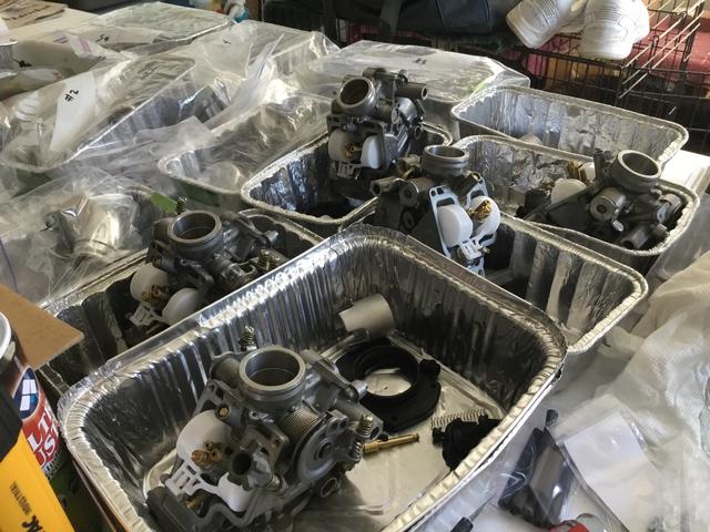

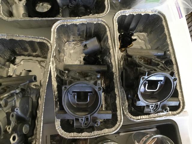

Be very organized. It’s a lot of tiny parts. I use baggies and plastic bowls for each carb and work on them one at a time. Take lots of pics before you tear into it. Keep all the removed parts separate for each carb (labeled) and make sure you have a replacement part in your kit. Springs, screws, jets, etc.  For sure rebuild the fuel rail and petcock while you’re in there. All new fuel lines are a good idea. Desmogging is helpful to add room in there if you want to do something like cruise control later. Plugs and plug wires if you think you need them.
