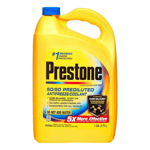

whats the consensus on engine coolant? book says Honda stuff mixed 50/50

« Reply #16 on: June 01, 2020, 09:34:27 PM »
Prestone 50/50 at Walmart.
2000 Valkyrie Tourer
yrunvs
Posts: 205
Prior Lake, Minnesota
« Reply #17 on: June 02, 2020, 03:04:49 AM »
So any 50/50 silicate free antifreeze will work?
« Last Edit: June 02, 2020, 04:56:21 AM by yrunvs » Logged
I'm no gynecologist but hey I'll take a look!
« Reply #18 on: June 02, 2020, 05:37:27 AM »
yes
