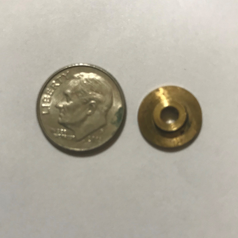

Information and knowledge are not the only benefits of this forum. Last weekend, I tried to PM my turn signal switch and lost a small bushing due to my incompetence.
I posted my problem on Sunday evening. On Thursday, this obscure bushing was in my mailbox. Sent by a member I have never met--no charge.
