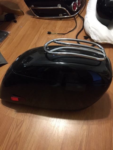

« Reply #10 on: June 16, 2020, 03:09:24 PM »
Meathead, I bought that same set and put them under a HF press. I used just enough pressure to flatten some of the curve out of them. They came out great and the chrome never “popped”.
I'll post a picture soon.

« Reply #11 on: June 16, 2020, 03:22:27 PM »
Here are those same racks, that I had to flatten out some.
2001 black interstate
2003 Jupiter Orange wing
« Reply #12 on: June 16, 2020, 09:24:17 PM »
Those look good. Got a pic on the bike ? What did you use to flatten them out ?
Steel cowboy
Posts: 1289
Spring Hill, Fl.

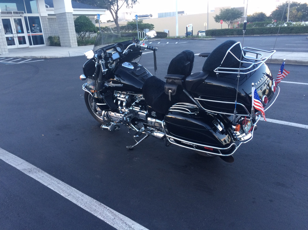

« Reply #13 on: June 17, 2020, 03:59:16 AM »
2x6 blocks of wood, I set it up so the “legs”were not on the wood. I put a piece of metal above the top 2x6 to distribute the force evenly. It didn’t take much to remove the curve and flatten them a bit. I kept checking the rack by placing it on the bag (tape the top of the bag). Then used the finished rack to check on the second one. I used metal roofing washers from Home Depot between the rack and bag lid, they have a rubber washer glued on to the galvanized metal washer. I picked up a set of interstate bags with stone guard and Honda line racks so these bags are my spares now. Sorry not for sale yet, part of my “back room” parts warehouse. Lol.
This is an older picture, I hope this helps.
« Last Edit: June 17, 2020, 04:13:06 AM by Steel cowboy » Logged

JimC
Posts: 1826
SE Wisconsin
« Reply #14 on: June 17, 2020, 11:22:30 AM »
Cowboy,
Those look better than I thought they would, nice work!
I think because they stop at the front of the trunk, they look like they were factory.
Definitely an option.

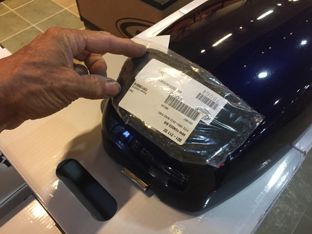

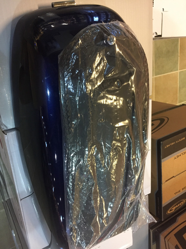

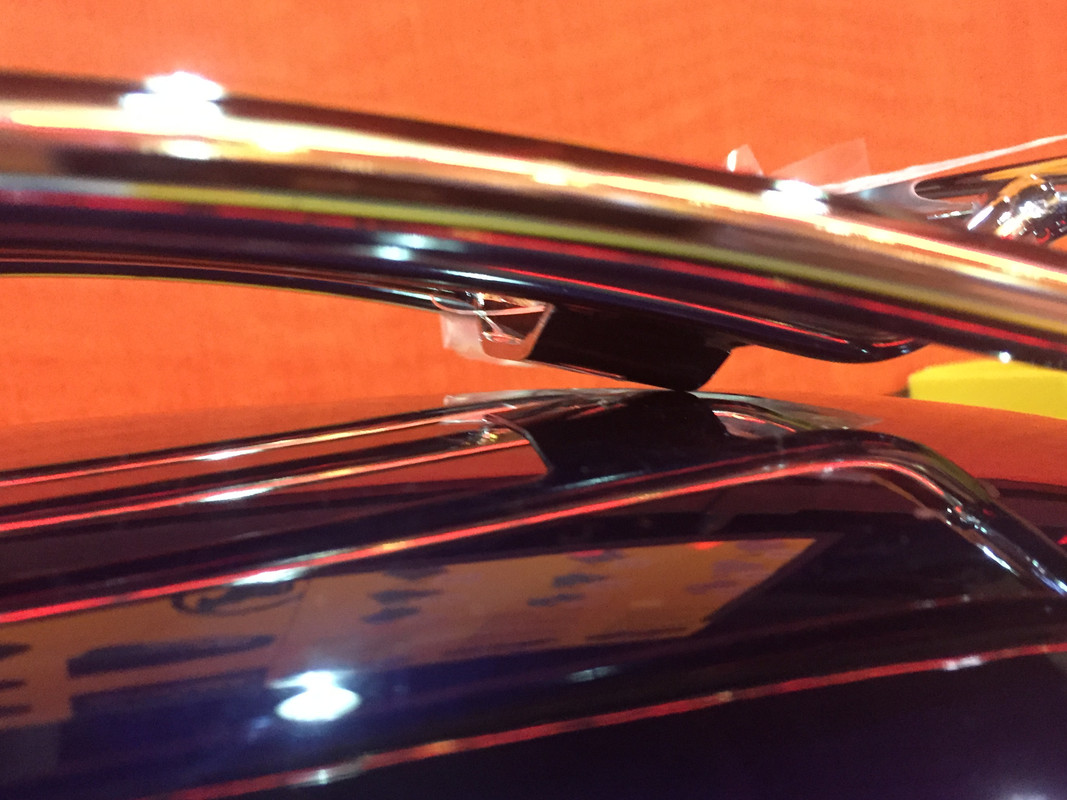

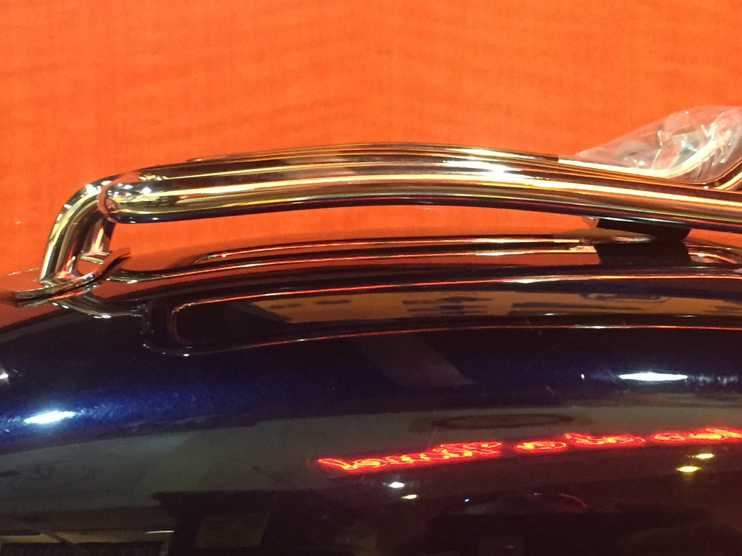

Jims99
Posts: 822
Ormond Beach Fl.

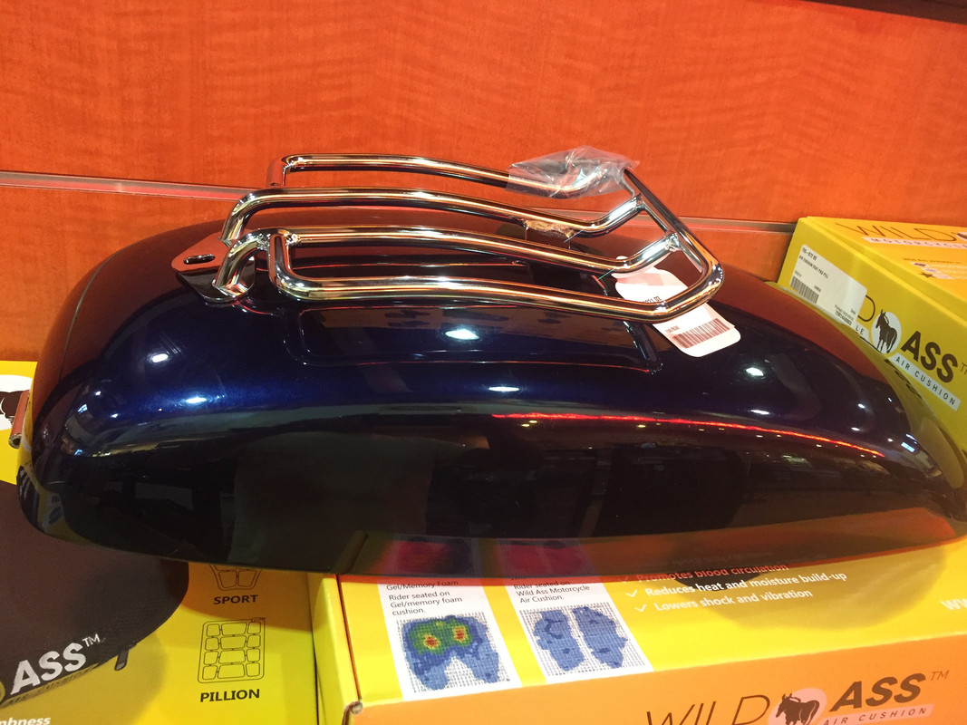

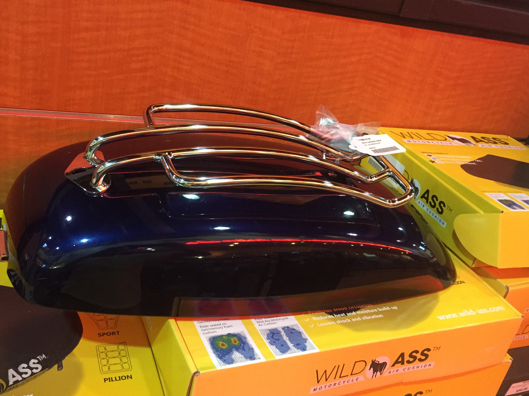

« Reply #16 on: June 22, 2020, 05:32:29 AM »
Here’s what I found at jp. Nothing they had on the rack fit right, but the short one was the closest. They also had fender bibs that would work. Pictures of them aren’t the best, couldn’t take them out of packaging.
« Last Edit: June 22, 2020, 05:49:26 AM by Jims99/00 » Logged
