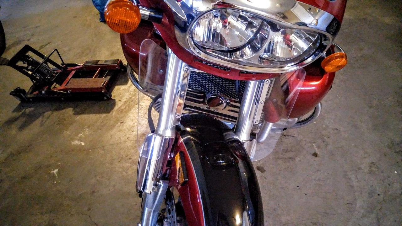

I've been thinking of doing something like this to my I/S
Not sure if anyone makes them anymore and can't quite see how they attach.  When I look at my forks I don't see any mounting tabs or holes.  I figure I can always make my own plastic and possibly use fork clamps to attach them.  Just wondering if anyone here has any source or pics of how they are mounted.

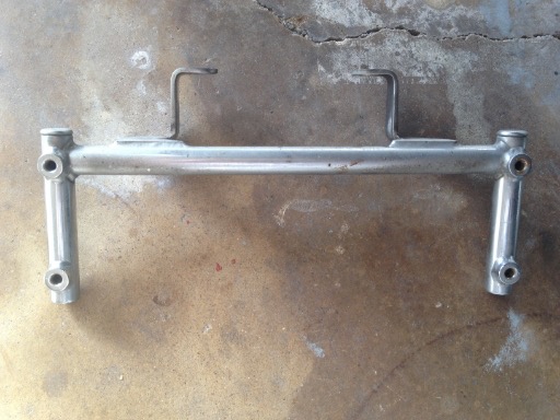

In the picture, they attach to a round crosspiece mounted under the tree, and then the three screws each side on the flat down legs.  That mount came with the original smaller fork wings, and new larger ones have been made/cut to fit the existing mount.
Most (many) Interstates have short wings under fairing too (on each side), and (I think) those are missing in this picture.

The ones on the red interstate are the Honda aftermarket. (I have them on both my interstates)
The BBTs ones are different, but may still be available.
Once you get a mount, you can make any size plastic you want for that mount.

The set that you have pictured is attached using two bolts to the bottom of the triple tree.

The ones in the pic are Hondaline accessory for all models of the Valkyrie.  They mount under the triple clamp by removing the two 12 mm nuts.  They are still out there but hard to find.  Most show rust and need to be rechromed.

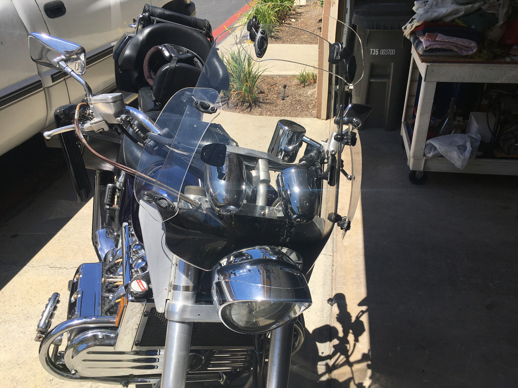

Made mine from aluminum stock, less than 10.00 in materials.. solved a buffeting problem I was having. My bike's not ugly by any means, and certainly no showpiece.
I could polish the aluminum but really don't care, it looks fine and does the job. In fall I may make some lowers for cold weather riding.

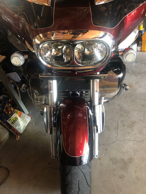

Finally got my air deflectors from BBT, all the way from New Zealand so I had to check them out.  Beautiful day low 80's not humid nice and sunny with a slight breeze so naturally after I took a spin to check them out they worked well and it was so nice I just kept riding the back roads.  Four hours later I'm finally home.  I could have kept going but had to feed the dogs and let them out as the wife is working the evening shift at the hospital.
For those of you who need to know I thought the deflectors were well worth the money, I didn't have  a big problem before as the faring does an excellent job but there was just enough breeze in the wrong place that I wanted something and these work.
