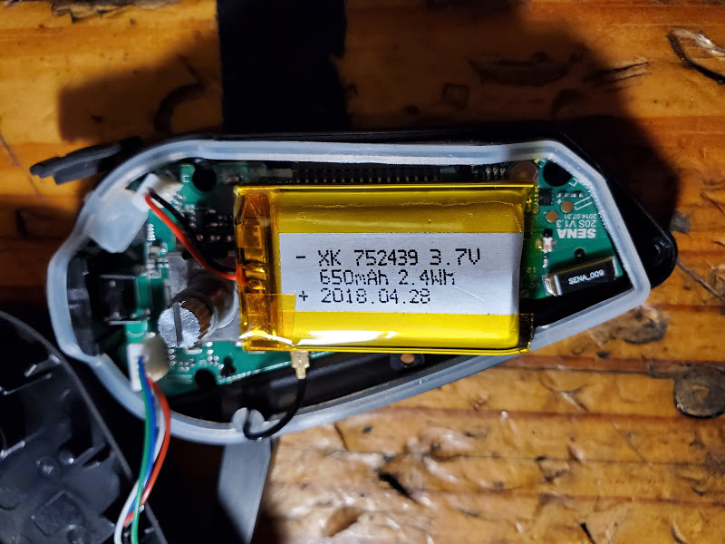

Just an update, figured I'd start a new thread instead of digging up one of the old ones.
The battery in the Sena 20s seems to be its' weak point, and it's officially not replaceable. I had Sena replace both units about a year ago under warranty, and on a recent ride with Kali mine was only getting about 3 hours of talk time before depleting the battery, so I re-researched replacement batteries for the unit.
In the past, this required soldering, and I'm not good at soldering so I hadn't considered that an option.
Since them, drop in plug and play replacement batteries have become available.
The hardest part was finding my Torx T8 bit that's required, and prying the old battery off the circuit board (It's stuck on the board with some sticky tape) without breaking anything.
Took about 30 minutes, taking my time, to replace the batteries in both of my Sena 20S units, and so far so good! Had to massage the new battery a bit to get it to fit but it's in there, slightly higher capacity too...
So, now that the batteries on the 20S are easily replaceable, wanted to pass that little tidbit along...
Video on replacing the battery with the new plug and play battery:
https://www.youtube.com/watch?v=u8chy14Btg4
The batteries I purchased to do the replacement:
https://www.amazon.com/gp/product/B07TZBRS82/
One of mine with the old battery still in place:
The bad battery had gotten "puffy", which is the death knell of LiPo batteries. The other was starting to get puffy but hadn't gotten too bad yet...
Anyway, just wanted to pass on the info that the batteries are now pretty easy to swap out in the Sena 20S headsets...
This sounds like the batteries are being over charged. A very bad condition for any Li battery (look on youtube for overcharging).
How do you charge this devious? I suspect that your charger is at fault and this will take out the replacement battery too.

I have a decent quality USB charger connected to my SENA Units, from my research as to the causes of LiPo batterys to puff up, I think the real problem is that they were being charged in my garage. In Texas.....
I've moved the charging station inside the climate controlled portion of the house after the battery replacement, we'll see how it goes....
But high temperatures are listed as one of the big issues involved in premature LiPo battery failure...
