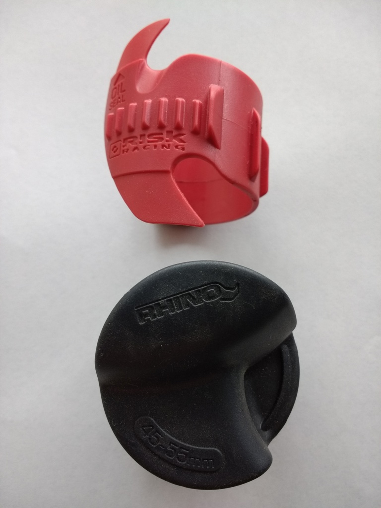

So my front forks are obviously leaking towards the bottom. Any tips on if this is an easy job to DIY or what the cost is to take it in? Any help, as always, is greatly appreciated. Thanks again! cooldude

Get a seal mate or seal doctor and should fix it up if it's not too far gone

shadowmagic
Posts: 229
« Reply #2 on: July 11, 2020, 10:54:45 AM »
Ok Frank, thank you for that tip. Ill order one now and give it a shot. I assume I need to add some kind of oil in there as there is a small amount that has leaked out, probably 2 or 3 tablespoons.

« Reply #3 on: July 11, 2020, 11:10:33 AM »
The Seal Doctor costs more, but does a better job and is far easier to use.  Well worth the extra $$.

« Reply #4 on: July 11, 2020, 11:11:24 AM »
I wouldn't worry about adding any oil, unless it's just been gooshing out.
If the seal mate works (it worked for me one time) they might
not leak again for a while  cooldude ...

Posts: 10516
« Reply #5 on: July 11, 2020, 11:11:31 AM »
Spend the extra for the Dr., it's worth it for ease of use and longevity.  Dave beat me!

Really, if you get the Seal Doctor and do a good job of cleaning the seals out, you will likely stop all leaks for a long periods.  I kept mine cleaned out for several years (small seeps came back occasionally, and I cleaned again) until I finally could hire a guy who knew what he was doing to rebuild them.  Mostly, it's just debris/crud/dirt that gets up in there, if you lose of chunk of seal, lots more fluid will seep and you'll know it.
In 3-4 years, I never lost enough fluid to affect function that I could ever tell.

fork nut tool, an electric heater element wrench is the same ID and OD needed. just need to notch the round end to work. large socket other end for torque wrench.
https://www.homedepot.com/p/Camco-5-in-Screw-In-Element-Wrench-09883/206807374
I made this tool when I did a complete teardown a few months ago. It worked well. The OP won't need it if all he's doing is replacing the seals. The springs do not need to come out of the tubes for that.
I also used another modified element wrench to remove and tighten the inner stem nut.  just had to thin the ID of the tabs a little to fit.
