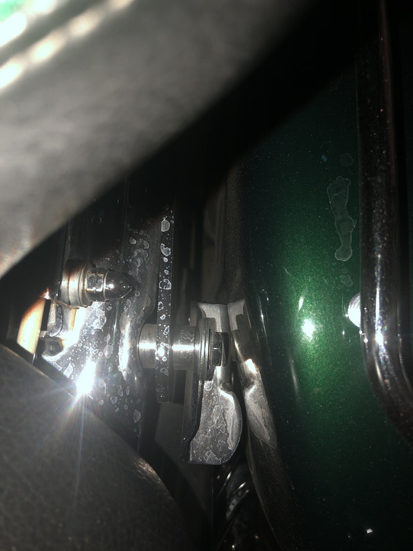

« Reply #25 on: July 22, 2020, 10:00:30 AM »
I wish they would put the model number on the sticker or stamp it into the steel. That or provide dimensions online. Anyhow, here's what I see on the used hitch I've got that I've never installed.
The welding of the side plates are not parallel - there's a slight widening of the side plates as it moves forward on the bike. Starts at 10.5" clearance on the bottom and gets to 12" by the yellow arrow - at which point there is a clear bend in the steel to bring the side plates closer back to parallel - but not exactly. I've got 12 5/8" clearance on the rear bolt holes, about 13" on the front. Enough to fit.
You can see the machined bend by the white pipe reflection getting all wobbly at the yellow line.
The tourer has about 12.5" across where it needs to mount so I'm certain the top end will fit. It's the bottom I'm concerned about as I have the fender tip and bag rails similar to meathead's setup.

« Reply #26 on: July 22, 2020, 10:33:25 AM »
I'm pretty sure it will fit just fine.  cooldude (I'm pretty sure the OP's would have also)
