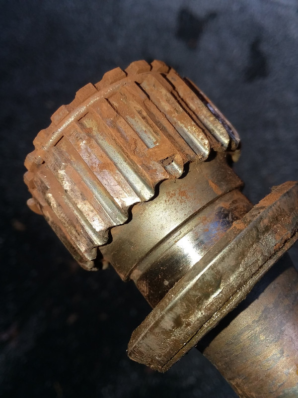

on my recent ride. I went for a week but came home after 2 days. There was a weird vibration that I couldn't identify the source of but I knew it wasn't right.
Knowing BigBF was going to be working on my bike doing the timing belts I figured I'd let the Valkyrie whisperer take a look see. The seal had broken.
He carries the needed parts.

Glad you were not stranded Paul cooldude
« Reply #2 on: July 23, 2020, 04:19:39 PM »
Phew.
« Reply #3 on: July 23, 2020, 04:47:57 PM »
That thing was toast.  Shocked

Wait until you see the photos of the pinion cup tomorrow.  Shocked Shocked Shocked
When the bike didn't "feel" right I made sure to be gentle on the throttle. At one point I had a Yugo take me at a stop light.  Cheesy

How many miles since you did a rear end check?    Did you put grease on the pinion before re-installing it when you did your last rear end job?   Just curious.
« Reply #10 on: July 24, 2020, 07:20:58 AM »
About 10,000 miles ago with a new rear tire.
Everything was cleaned and relubed.

I've seen so many of those desert red clay dust pictures of the drive unit here over the years (but never in my bikes).  It's like an archaeology dig exhibit.
So that's what happens when water gets down in there (for a long or short time)?

    Same thing happened to me,   but the good news is that those parts-  the drive shaft with a revised part number, the seal and pinion cup are still less than a regular motorcycle drive chain..!   And that hole visible in the shot is important to keep clear and open, since it lets gear lube from the rear end get in there.
    Now I check it every tire swap.

BigBF waved his magic wrench and all is hunky dory.

Just over 80,000 miles.

That seal needs to be replaced regularly, since it begins to harden up  after about 10 years.And then it  works loose from where  it should be, and the result is what you see in the photos
