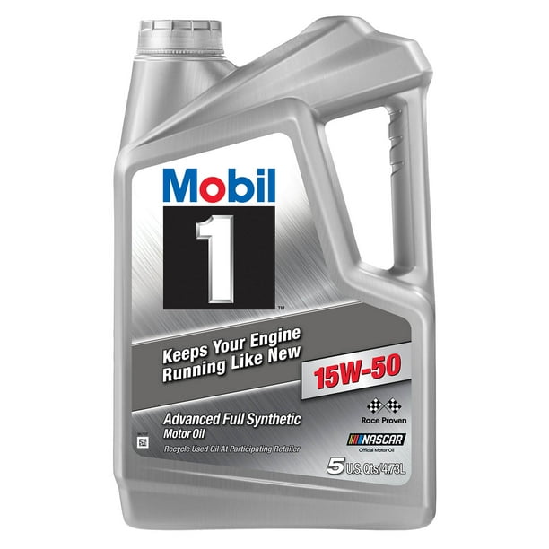

what oil are you guys useing?
~ Ron Pierce ~
~Ahwatukee, Arizona~
~VRCC 20050~
~TOI  27850 ~
~2000 Valkyrie / DFT ~
« Reply #12 on: July 30, 2020, 08:32:59 AM »
This is my choice because of the heat here. (I'm sure there will be many detractors soon)
~ Ron ~
Posts: 35
It's the right thing to do
Ahwatukee, Arizona
« Reply #13 on: July 30, 2020, 09:11:16 AM »
Thanks
