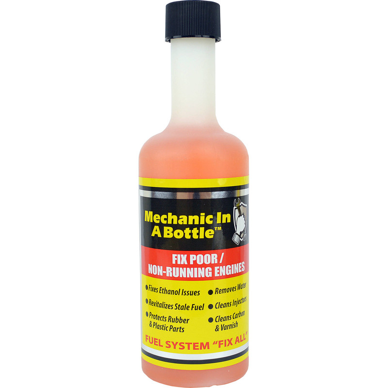

« Reply #7 on: July 30, 2020, 05:18:01 AM »
I have a buddy whom I respect for his motorcycle knowledge that recommended this stuff. Has anybody here tried it?

« Reply #8 on: July 30, 2020, 05:38:51 AM »
Just watched a few vids on youtube and that product ^^^ does not seem to work as advertised.  It could for some, but not just add and go.  If a set of carbs is really plugged and has residue in the float bowls not much will really help besides to that the residue out manually.

« Reply #9 on: July 30, 2020, 05:51:42 AM »
Yea I took my carbs off a couple months ago and (thought) I had cleaned everything but I'm afraid I could have done a better job and will need to re-do it. I was hoping since they (carbs) were mostly clean I could run some magic liquid through to flush whatever is left out but I suppose that's just a dream and I'll have to take them off and do it right (the second time).
PuyallupValk.....The moral of the story is there probably is no liquid magic to clean the carbs out and so do it right the first time by pulling them off the bike and breaking them apart and installing new jets and checking the air cut units and flushing the fuel galleries or there will be a second time.
