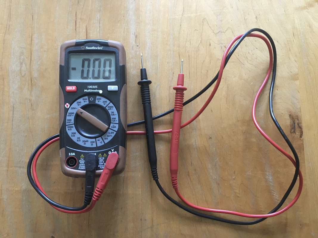

My experience is the alternator either works or doesn't work--not too much intermittent failures. The quickest, easiest check is the multimeter at the battery. Once you get a multimeter, you might be surprised how often you use it. Used mine today, BUT had to replace the battery, then re-solder the battery clip leads to the circuit board (the leads broke loose as I replaced the battery), then it worked again. Checking an EVAP Canister Vent Valve solenoid on my van. I try to convince my kids to get a multimeter (or I have bought one at the box store) so I can trouble shout the problems they ask me to fix (e.g., why doesn’t my garbage disposal work?).
If you thought there was an intermittent failure, you could even go for a ride with the multimeter hooked to the battery and duct taped to the triple tree.
I have a voltage gauge wired directly to the battery on my Valkyrie (except for the relay to the on/off switch).
If the alternator is bad (and just because the battery voltage does not change does not mean the alternator is bad), there may be some simple checks and repairs, but that should wait until you determine whether your problem is the alternator or the Kuryakyn light. As suggested above, the sitting voltage of the battery would be 12+ volts. Running above an idle should be 13+ (and you should see a noticeable jump in voltage). If there is no change is voltage while running, you have a problem.
. . . .Course I'm not idiot enough to go on any long rides until I figure it out (better).
After the alternator light came on, my kids usually kept driving the car until the radio quit or the car died (I think I taught them you could limp home with an alternator light; but shut down immediately with a temperature or oil pressure light). My daughter learned new profanity when I had to change the alternator on an old Saturn on some random street in Lafayette at 10:00 p.m. (the alternator was accessed from under the vehicle).
When I was not sure whether I could get my multimeter working again, this is the multimeter I found after a VERY brief search.

So pardon my ignorance, but do failing (or failed) brushes result in a slowly deteriorating alternator, that works well enough but not fully for awhile, or is this an on or off proposition?
Would failing or dirty (or whatever happens) brushes cause the idiot light to be alternatively green then red then green.... for awhile?
The brushes supply current to the windings on the rotor, through the 'slip ring' copper contacts on the rotor, and the current supplied through the brushes and slip rings creates the magnetic field in the whirling rotor that generates the electrical output in the windings of the stator.
If the brushes are worn, grimy, jammed, etc. to a degree that they are making some electrical contact - but only making poor electrical contact - with the 'slip ring' contacts on the rotor, then your alternator will be partially effective at generating useful output- and will do better at higher RPMs.  Alternators always have rising output, up to their max capability, as RPMs rise - but in this degraded condition, the RPMs will need to be higher than normal to produce useful output.
And once the situation involves poor electrical contact, that poor contact creates extra heat at the poorly-contacting-surfaces, and that heat will accelerate the demise of the brushes, or degrade the surfaces on the slip rings, or both. The outcome only goes downhill once it starts going downhill.

In ideal conditions a lead acid battery will be 2.3 volts DC per cell, so a "perfect" 6 cell battery will be 13.8 volts, this will decrease with cell condition.
Charging system voltage is usually right around 14.2 volts DC and that is what you will see if the engine is running and the alternator is putting out.
The indicator light that you are using is not the same as the old "idiot lights" that were used in most cars etc.  That style light has battery voltage on one side and charging system voltage on the other so if either voltage is higher than the other ower will flow one way or the other and light the light to indicate a problem with either part of the system.
The light that you have will sense the the circuit voltage and then light whichever of 3 LEDs is in the range - low voltage red LED, medium voltage will be higher than the red LED range but not in to the green LED range but will light the Yellow LED etc.  The LED went green when you plugged in the battery tender showing that the battery tender was putting out acceptable voltage.
As suggested you can get a cheap multimeter from most auto supply places, Amazon etc.
Here is a link to a how to on testing charging system components on the vehicle.  It details output tests as well as checking diode trio and battery.
https://axleaddict.com/auto-repair/Alternator-Problems-and-Automotive-Charging-System-Tests

Thank you for the good information Vermonter and MadMike (and everyone).  cooldude
I will get a multimeter.  (I don't have one since auto electric has always been witchcraft to me)
