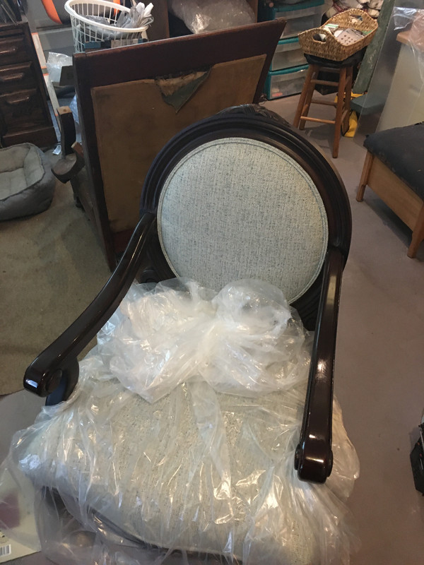

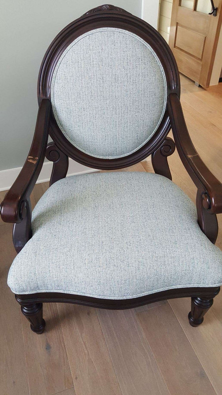

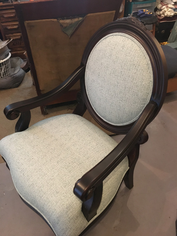

I got asked to repair a chair that was in a car accident,  Yep who wudda thunk it.  lol
This guy took a real nice chair to the upholsterer for his wife.  They did a good job and the chair looked great.  He then stuffed the chair in the trunk of his car and padded and tied the trunk lid down and headed home.(I bet he regrets that move) anyway on the way home he got rear-ended.

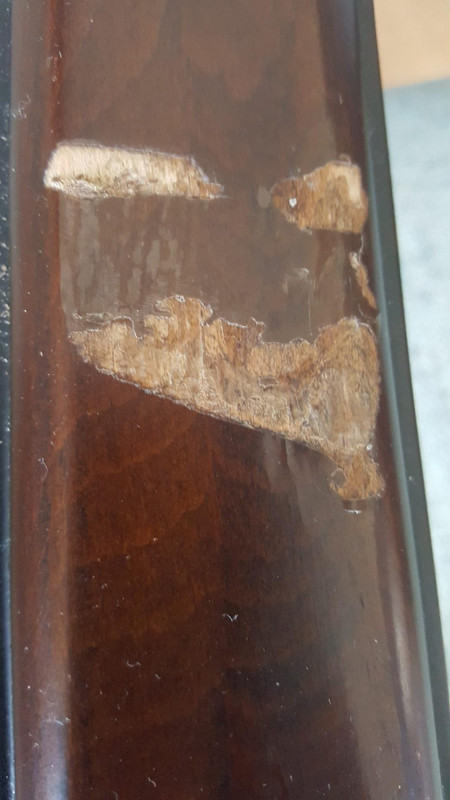

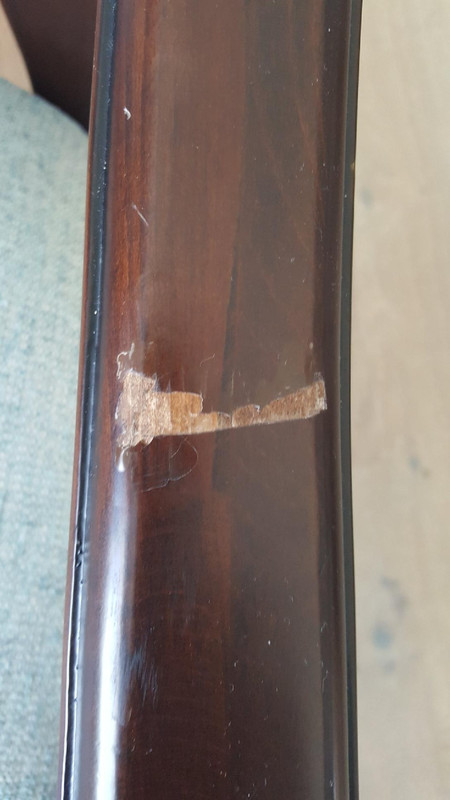

The chair only got damage on the arms, but its like the MOST visible area so the repair was critical

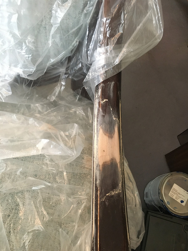

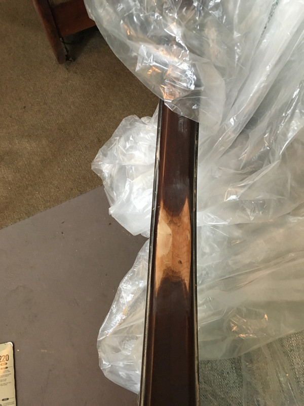

OK, the damaged areas had to be sanded to bare wood and then try to restain the arm to match.  Sounds simple?  Well, its simple in theory, but anyone that has tried this knows the outcome is unknown until, well until its known.  lol
Red Oak was the perfect color and that was the lucky part.  After staining, the stain dried way too shiny and then when I rubbed it down to dull the repair shown through.  It took several tries and experiments with clear under the stain, over the stain, etc.  to get it right

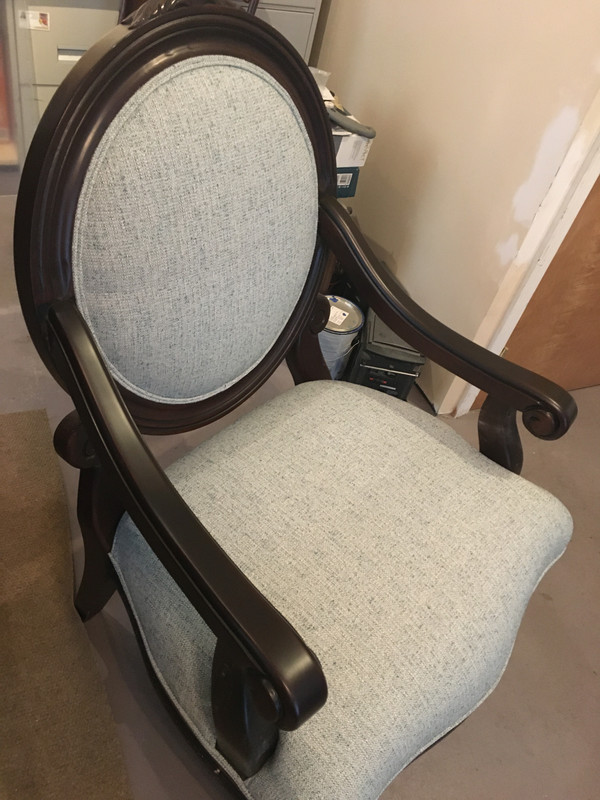

Finally today I got it right and got it finished.  It really turned out better than I had even hoped.

Excellent! Great restoration work.

Very nice work Chrisj CMA,  one would not know it was ever damaged.  I tinker with woodworking and know how difficult it can be to match stains / tones / texture when repairing or making replacement parts for old furniture.  I have found a guy on youtube that I really enjoy you may like as well.  He goes by Thomas Johnson Antique Furniture Restoration.  Again nice job!

You do nice work, that looks good. Thats hard to do !
What was your final formula ? What ended uo working the best ?  That takes patience.

Ok I think I can explain but it’s complicated. First heavy stain on just the bare wood. Once dry lightly sand the whole arm. Then clear coat even though it still looks like crap at this point. Then when that is good and dry light even coat of stain on the whole arm and then while still very wet, heavier on the repair so the heavy stain can blend with the lighter coat so there is no interruption in flow. The idea is to not cover ALL the natural wood grain. When that is dry it’s too shiny so it needs rubbed down with steel wool but no matter how careful you are the repair starts to show through. So concentrating on the whole arm not just the repair you have to achieve the correct sheen over the color. Then clear again. I had to repeat this process four times until I could rub the shine off without the repair showing through. Once it’s the right sheen and one even color. Then two coats of matte clear and that’s a wrap.

Hmm, OK, thanks, interesting. Staining over the clear, I would have thought that had to be sanded off. I'll try it sometime. 4 coats and all that work took time. Worth it though isn't it, looks good.

Thanks. Yes it’s worth it when a repair looks like nothing ever happened. That is not always possible but it’s always the goal.
Putting the clear under the stain makes the stain behave more like paint so you have to be careful not  to get it on too heavy. Make sure you lightly sand with 400grit or finer before putting stain over clear
