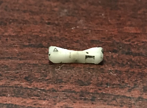

Never had a problem inserting the ignition key....until today.  The key would only go in about halfway and no further.  After many, many attempts, I got a bit forceful and pushed hard (hey, I had to get home).  Once home, the key was very tight to remove, but when I got it out I blew some air into the slot and a small piece of plastic came out (about 1/8" x 1/16" x 1/16"). Are there plastic pieces in there or did I somehow get a small piece of plastic that slid into the key slot??  Key is still tight going in and out, but seems to be functional....

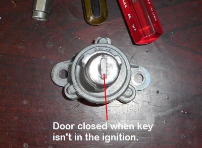

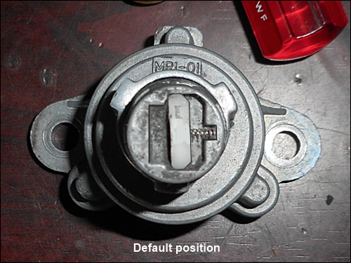

I took some pics in 2017. The *door* can be put back if you like.

That "door" is not plastic is it?? The piece that came out looks like a portion of the bottom "door" with the 45 degree angle (bottom right).

Overview.
The door is scalloped on the leading edge.
The scalloped edge enables the tip of the key to nudge the door to the side when the key is inserted in the key slot.
Unfortunately, the widest part of the scallop overlaps the bore for the coil spring. This flaw in the design results in a weak spot prone to creasing, so forth (dotted circle).
Something like the below. Also, my theory is if the tip of your key isn't rounded off, the square edge is likely to damage the door. Of course after 20 years plastic gets brittle. I would think the door is nylon but I suppose even nylon eventually gets brittle exposed to UV and medium heat and thin as the door is. Perhaps, redeye could mass produce *doors* for the boys, I dunno. Then, is the door even necessary?
