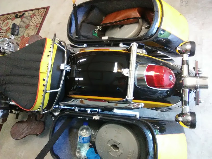

Here is the problem, I have a new seat and it causes me to sit differently (I suppose until it gets broken in) and my feet are not comfortably positioned on the road when I am stopped. With my stock 13" shocks, I was able to have both feet flat on the road with my knees bent and legs splayed out a bit, on the new seat (which is the same as the old), not so. To compensate, I added an additional 60 lbs of weight in my saddle bags, and put the shocks on the lightest preload which works to give me a comfortable stance when stopped, but causes me to be more into the sag of the shock than it should be. Also there are other obvious reasons why this is not a good solution!
