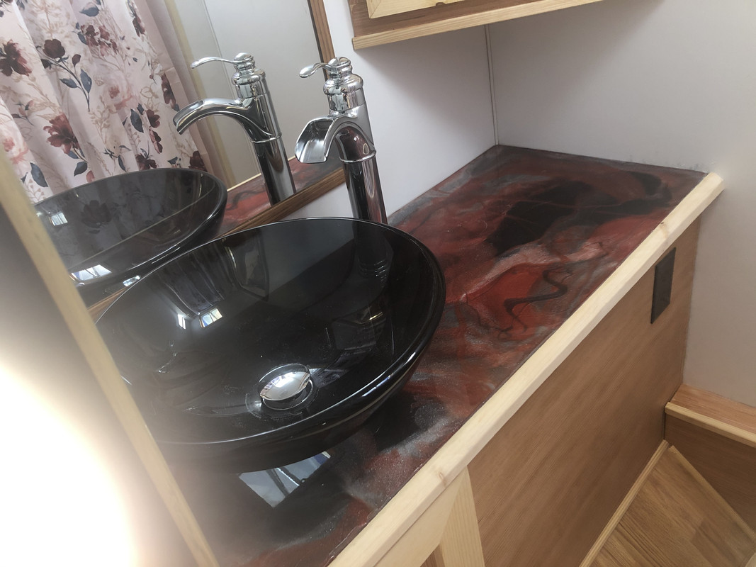

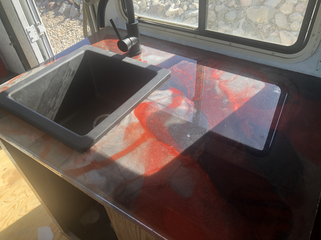

We (mostly me) poured the counters. I’m not very good at taking pics. But I think they came out ok. I made a number of mistakes. I would definitely be better if I ever had to do it again.

« Reply #15 on: November 09, 2020, 07:35:28 PM »
Hey that’s pretty cool looking. Good colors cooldude
How did you do it, in place or in a mold? How much epoxy did you use?
« Reply #16 on: November 09, 2020, 07:52:53 PM »
I think the best way would be in place. But because I had 3 separate counters in a 24' motorhome, getting the motorhome pretty level and all 3 counters perfectly level at the same time was going to be too hard. After fitting new counters in place, I removed them to sawhorses in the garage and did them in there. The temperature range for a good cure is 70*-85*. For weeks I had the epoxy project on hold because it was still hitting 100* here. Then when temps started to moderate it got too cold. It went down to a high of 70*. We finally got in the right temp range after a few days. I bought a 2 gallon kit of epoxy. I only used a little over a gallon. There is also a table that I didn't take a pic of because it's not installed yet. Brenda has picked the color scheme in the motorhome of gray, maroon, black. The coloring that I added is a metallic mica. It looks pretty cool in the light.

« Reply #17 on: November 10, 2020, 03:46:46 AM »
The time you waited paid off. I like them. Real good design patterns. Hope they hold us and you get years of use.

Posts: 6514
« Reply #19 on: November 10, 2020, 04:36:23 AM »
Looking good Rob cooldude

« Reply #20 on: November 10, 2020, 05:28:15 AM »
How thick is it? You just poured it and it leveled itself? -
it looks smooth and shiny...

« Reply #21 on: November 10, 2020, 08:11:46 AM »
It looks like it has “depth” to it which is one of the things I like about it.
Did you pour the colors first and make the design and then add a clear to top it off?
