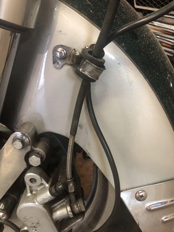

Got the front wheel on with the blinged out brake calipers, plus the Spiegler lines....
A few pics....

Couple thoughts... .
I went waaay out of my way to duplicate the brake lines with Spiegler steel and in retrospect,
not 100% pleased the way it turned out, would do it different if there was a next time...
Wondering if there is too much shiney stuff going on. Another maybe next time, to anadize the center of the rotor red...
Generally happy another step is done on this thing   cooldude

« Reply #3 on: September 24, 2020, 06:51:19 PM »
The SS lines are so stiff the line holders twist the things the wrong way, and would ding up the paint too. So, yeah, leaving them off. I will see how it goes, if needed, I think I will fab some holders that work better.
I would do the lines all over if the things weren't so pricey.. but I have too much $ in them already...

« Reply #7 on: September 25, 2020, 01:50:03 AM »
Put the brake line holders on Mello (or fab some from stainless) the lines will abrade your paint in short order. It's particularly annoying on custom paint with multiple layers of clear (don't ask me how I know).

« Reply #9 on: September 25, 2020, 07:36:54 AM »
I went the opposite way on my '01 I/S and blacked everything out. Including a set of Unobtanium(TM) Hondaline lower fork covers and Show Chrome radiused caliper covers.
Only things left to do are to get another set of wheels, black them out then order a set of rotors with black carriers and swap the front end around.
« Reply #10 on: September 25, 2020, 08:06:32 AM »
What I'm worried about is that it doesn't look like there is enough slack in the brake line. It looks like if the bike was raised, or the forks extended going over a rise, that it could put tension on the line.
You can't tell by the photos, but the forks are fully extended and the wheel is about a half inch off the ground, so the lines are at max extension too.
But you're right, I am stressing over the !ines... wondering if there is enough play in the whole deal. That's the trouble in going custom on things. Sometimes the results screw the functionality. Dunno if I should throw on the OEM.

« Reply #13 on: September 25, 2020, 12:02:30 PM »
Mello you're stressing again, that look's about how mine look when jacked up. Fitted mine in 03 and still going strong. BTW my lines came from HEL (here in the UK) very easy people to deal with and they give a lifetime warranty, plus loads of fittings, colours and finishes.

« Reply #14 on: September 25, 2020, 12:24:53 PM »
Lol, stressing is what I do.... hey what does your line hold down bracket look like? Pic?
I am thinking about having to do another fab job.... Tongue

« Reply #17 on: September 25, 2020, 08:03:55 PM »
I'm kinda at throw on the OEM for now, just to move forward. My head is spinning on the hold down thing. What would the right part look like?  All the movement on the fork is on the lower part and there's near no room for movement on the lines.... aaaaahhhh !!! Another design.....
I just need to get it on the road, I'm kinda burnt on the whole thing......

I'm not sure why the OEM holders won't work. I have braided lines with the OEM holders.

« Reply #33 on: September 28, 2020, 05:36:46 PM »
Hey Mike, just to clarify a little bit. The fender clamps on my IS with the braided lines aren't snugging up on the lines. The braided lines are in there loosely allowing them to slide thru with movement of the forks. They just hold them out from the fender, to keep them from rubbing. The stock lines have a rubber snugging them up. I imagine a rubber snugger could also be used on the braided lines. But they are a lot stiffer and resist this.

« Reply #34 on: September 28, 2020, 06:21:36 PM »
Back at it..... So I'm looking at the Spiegler grommets an they dont slide on the lines at all. Then glancing at the OEM parts and they are considerably larger dia...
My concern on this whole thing is that the suspension movement is from the bottom of the fork, and needs brake line slack to be functional.. and the stiff SS lines are not helping that.... Or am I overthinking again?  Tongue
Taking the OEM gromment and slipping it over the SS lines there is room for play....

« Reply #35 on: September 28, 2020, 06:27:54 PM »
So mounting it all up..
Right
Left
I am thinking for now the right may be ok, there's a bend in it. The left is shorter for whatever mistake reason I did, but not much room going on.  Crazy me, I may make another line thats longer. I am going to be watchin this like a hawk.
For the moment I'm done screwing with it.. .I'm doing the bleed job, (lots of fun with bone dry system) and tank goes on next.
« Last Edit: September 28, 2020, 06:35:43 PM by mello dude » Logged

May as well show the up front plumbing.  I dont think I would do it again this way... Its not helping the stiffness issue.
« Reply #37 on: September 28, 2020, 06:36:32 PM »
There should be no more extension from what you had with the bike lifted off the ground. I think you are fine.  cooldude

« Reply #38 on: September 28, 2020, 08:26:19 PM »
I do appreciate your feedback and everyone else's comment too.
