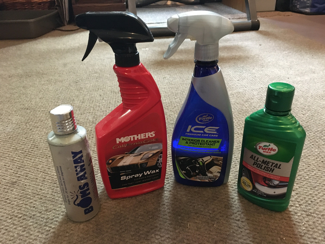

Bombs Away. This was a Florida coast wheel when I got it. Rough and dull. That was almost 19 years ago and all those years in North Florida. No clear coat and it never corroded again. Bombs Away without power tools.

I concur on Boms Away.  Best chrome/aluminum polish ever made (better than White Diamond which is also good).  It's a liquid, not a paste (a huge plus), but if you knock it over it's gone. Never seen it in any store, and you have to hunt on-line.
A good clear coat should last.  But a bad job may be a big mess on top of all your hard work.  Some folks can use rattle can with good results.  Not me.
Painting is a whole nother skill, and a perfectly polished wheel may not be so easy to get a good stick with paint (clear coat).
Wax is all I did.  And that took off 20 percent of the new shine.  But it did stay cleaner longer.
If you commit to scrubbing off the wheels once in a while they can stay pretty polished.  Especially with two sets of wheels.
« Last Edit: October 02, 2020, 05:54:42 AM by Jess from VA » Logged

Appreciate the advice and feed back.
I looked for Bombs Away, that looks and sounds like the way to go.
Still looking for it.   So far, this is what I've come up with:
https://www.linkedin.com/company/bombs-away
I kind of doubt that will get me to where I want to go.  Wink
Edited: Found it.  https://wingstuff.com/products/2689-boms-away-metal-polish-sealer

Check it out here. I think this is the guy who makes it. Bombs away
https://www.captainrichardsbest.com/bomb-s-away

The liquidy Boms Away flies off a buff wheel like water, so use very sparingly (and keep mouth closed).
Better to cut with compound, then back polish with the Boms away.
With buff wheels, the best plan is one for brown tripoli, one for white stainless/diamond, and 1-3 with nothing to clean off the compound.
