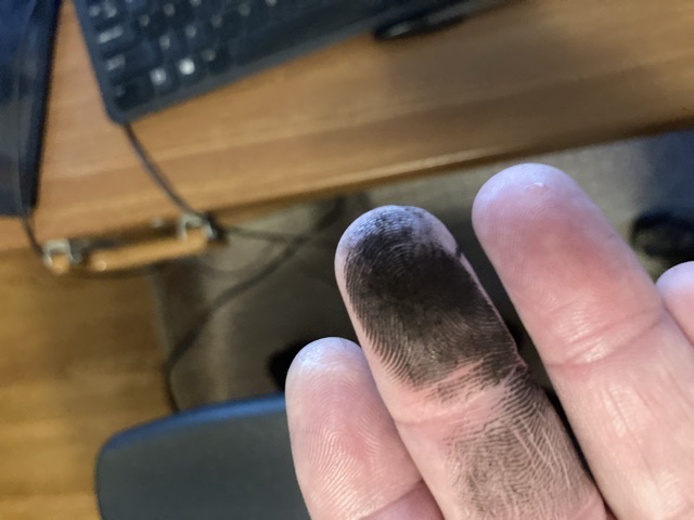

I'm just wondering:  Would you have a sooty exhaust pipe on only side if it were a single float valve?  I don't think he specified.
Terry
Sooty on both sides.

soot is from partially burnt fuel, too much fuel or not enough air to burn it up.  So carbs dripping excess fuel or not getting ignition, or insufficient air getting in.
Did you check for the rat's nest in the airbox??

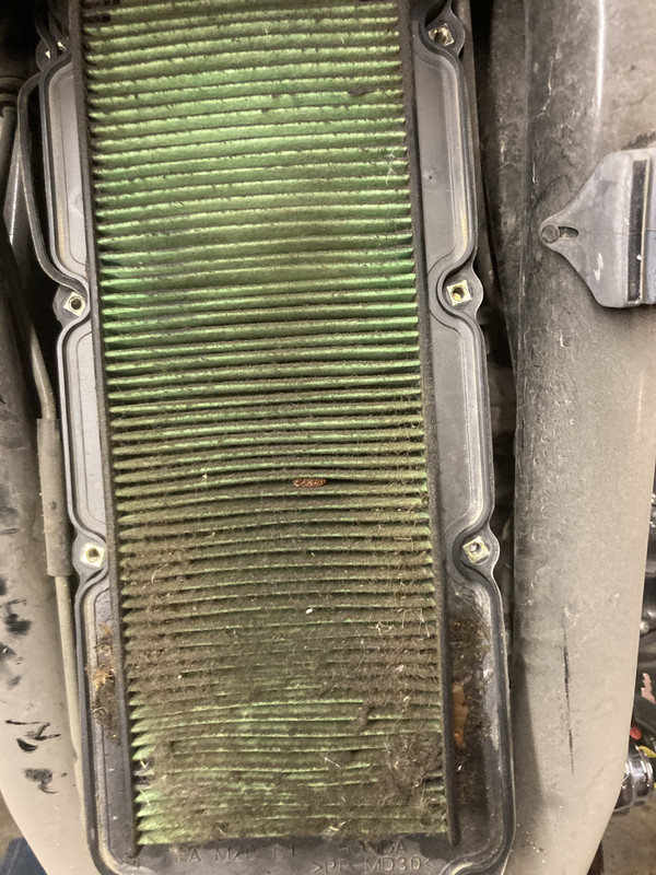

Mike I think I found the problem.
1997 Valkyrie & 2002 BMW F650GS
« Reply #21 on: October 20, 2020, 08:36:24 PM »
I think you did ! That's a lot of dirt on the frame rails also. Ride a lot of gravel, dirt roads ?
Can you see a trouble light through the filter??  That will help give you a real idea of how obstructed the filter is.  What is the fine dust on the frame rails??  If the bike was run in that kind of environment for long it may be packed in the filter and blocked it off.  I have seen heavy equipment with filters so plugged that the 6" rubber hump hoses get sucked flat and they black smoke like a tire burning.
Hope you got it.

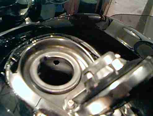

I've found it a little difficult to get accurate calculations on mileage due to the fill neck of our tanks.  It's difficult for me to know I've filled it exactly the same each refill depending on how much time I spend burping the tank on my 98.  But 28 mpg was what I had calculated years back however recently after installing All Balls Carb kit it seemed my RPM had dropped at cruising speed of 65 mph from about 3000 RPM to about 2800 RPM so I've run a couple tanks through to check mileage again.  At this point I'm calculating out about 34 MPG.  I'll probably calculate a few more tank fulls before I'm confident in what the actual MPG is but so far I feel I've made a good step forward.
Use an awl or tapered punch - HF sells a kit of them, some are long - to hog out the vent hole you can see in the filler tube looking from the left rear fwd.  Opening that hole which is perhaps 1/8" to a half inch will allow the tank to burp air while you top it off.  The steel is very soft, no need to drill and create filings or sparks in the tank.  See http://horseapple.com/Valkyrie/Tech_Tips/Burping_Brunhilda/burping_brunhilda.html
All of my Valks get around 34mpg when I stay below 4000 rpm - even the supercharged "George".  Sounds like carb work would be the answer.  A new set of plugs wouldn't hurt either.

Stoughton, Wisconsin
« Reply #25 on: October 21, 2020, 09:30:56 AM »
Wow, I don’t think I’ve ever seen an original 20-year-old air filter!

« Reply #26 on: October 21, 2020, 12:10:19 PM »
One look at that air filter is all I would need to make me give the bike a really good going over. I would NEVER use that dealer for anything else!

« Reply #27 on: October 22, 2020, 05:41:06 AM »
The dealer is sending me a K&N air filter for it. I don’t know how much riding season is left, Buffalo NY,  but I will update after I install it.
Posts: 30407
« Reply #28 on: October 22, 2020, 09:00:37 AM »
If they send the kit with the cleaner and oil sprays, do not over-oil the filter element (or be prepared for a little white smoke for awhile, and maybe a bit of plug fouling).  And use the prefilter (lays on top) it comes with, it's called for in the Valk application (though many don't).
