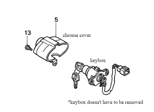

On my Tourer, I'm able to unscrew the chrome cover (5).
Then slip the sub-cover (A) off the keybox by releasing the retention barb from it's dipple. Item B is captured by the sub-cover (A) and pulls off.
This gets an unobstructed view. The keybox doesn't have to be removed from the bike frame.
2000 Valkyrie Tourer
