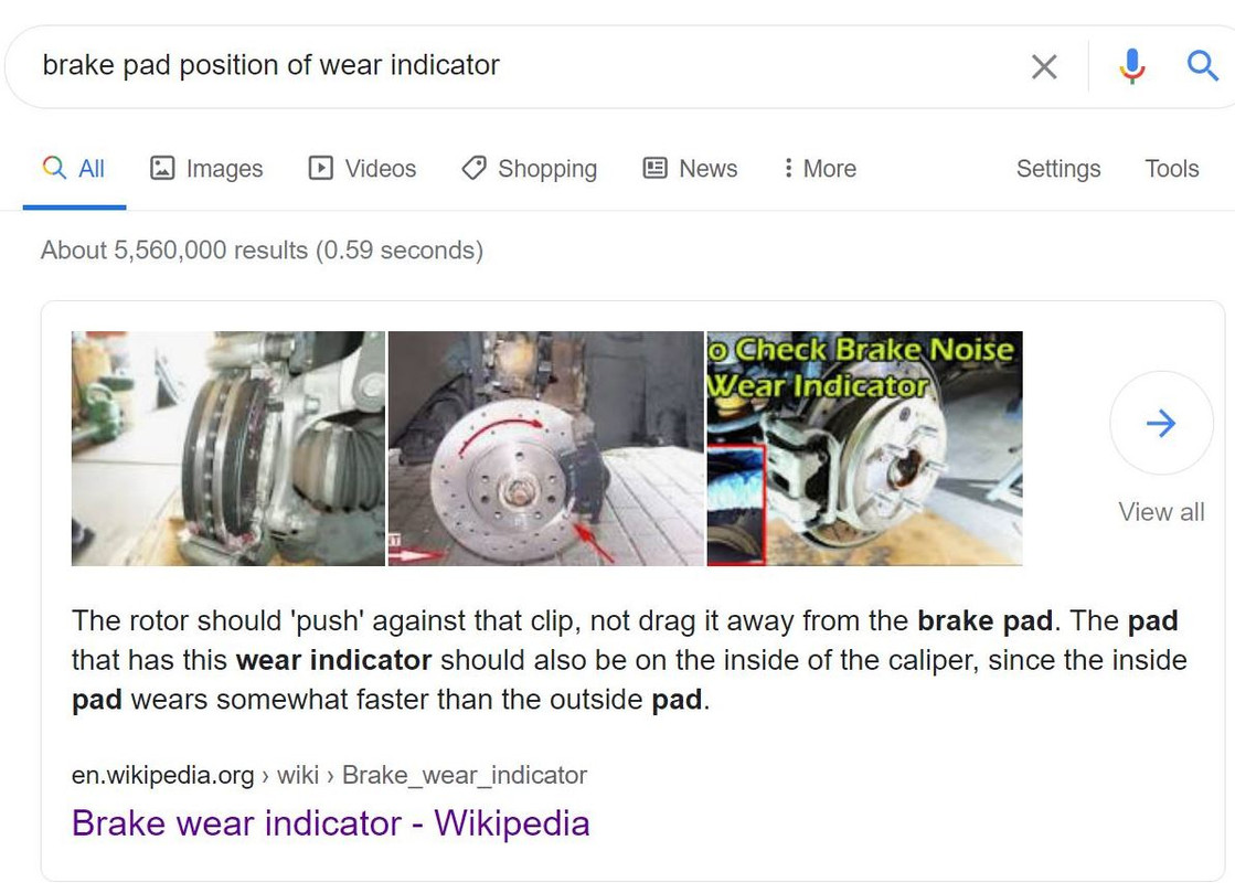

I’m replacing brake pads on my car and I’m not sure if the wear sensor or squealer should be on leading edge of the brake pad or the trailing edge. Looking to the Internet, it seems opinions are about evenly divided (although there does seem to be a consensus that if only two of the pads have sensors, those pads should be mounted on the inside next to the piston).
The Google result has the Wikipedia link (we all know Wikipedia is never wrong) stating the squealer is on the leading edge directly under the picture showing the opposite.

I put them on the inboard pad (caliper piston side) because the inner pad usually wears faster in a floating caliper system. When you step on the brake, the inner pad applies, and the force of that is what makes the caliper body move on the slides, which applies the outer pad. I put the wear indicator on the leading edge of the pad (as the rotor would turn while in motion). So, placement depends on your caliper orientation. If the caliper is behind the hub, the indicator would go on the bottom of the inner pad. If the caliper is in front of the hub, the indicator would go on the top of the inner pad.
