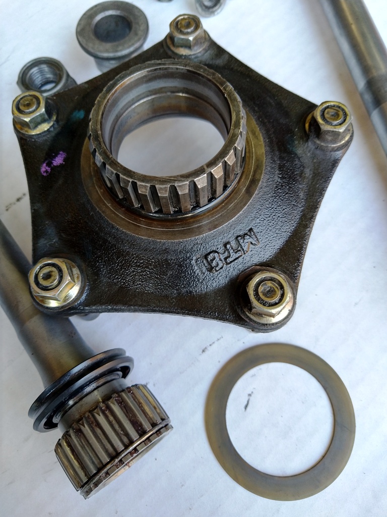

There's one thing far more important than lubricants, o-rings, and thrust washers:  tighten the big axle nut BEFORE you tighten the 4 nuts that connect the final drive to the driveshaft tube.  That will align the drive splines between the wheel and final drive.  If they're misaligned they'll grind against each other as the wheel rotates and wear out very quickly, sometimes before the next tire change.
The lubricant doesn't matter as much.  I've been using cans of wheel bearing and multi-purpose grease that have been sitting in my garage for decades.  As the picture below shows, my driveline parts looked great when I changed the tire in August at nearly 175,000 miles.  BTW that o-ring is the same one that was installed at the Honda plant in Ohio over 22 years ago.
Now here's some more maintenance heresy.  I believe more final drive parts have been ruined by improper maintenance than if they'd been left alone.  I owned 3 shaft driven bikes before my first Valkyrie and never did more than change the FD oil.  For nearly 40,000 miles that's what I did for my Valkyrie, until I read about all the maintenance I'd been ignoring.  So I frantically pulled it all apart expecting to see badly worn out components, but to my surprise everything was in perfect condition.
