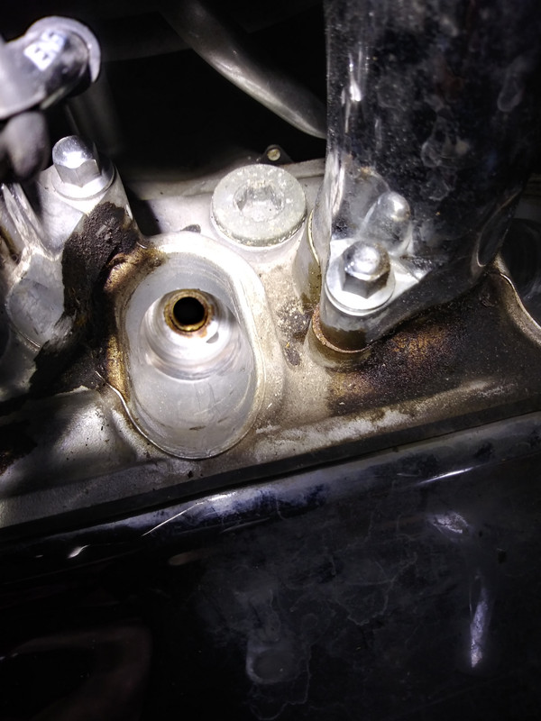

Another good thing happened this past Tuesday. I had been waiting for my 4 deg. T/W to come in then wait for it to be warm enough so the IR heaters had half a chance to work in the garage. Tuesday was it so went to work replacing the belts and installing the T/W. I left the cover off to observe the belt action and listened for a whine in case they were too tight. I usually just let the tensioner springs do the job and it was good this time as well. Battery was down so had it charging while working, and pulled a little vacuum on the petcock to let the carbs fill before spending time cranking. Finally all was ready so opened the garage door, hit the choke about halfway, confirmed it was in neutral and hit the starter. Fired a couple times but balked a bit so let it sit while I picked up tools. Tried a couple more times and away it went. I had installed some clean plugs, the old ones were covered with oil and rather dirty. That new T/W sure woke the old girl up, including throttle response. I let it warm up a bit and was able to release the choke, was glad it still idled although a bit slow so bumped that up to just under 1k rpm. Tested the rebuilt alternator output...looked good as well. One thing I noticed is all the hose clamps were loose so tightened the visible ones only, the rest will have to wait until I swap out the carbs...as will the intake o-rings which are leaking like a sieve...see pic below. Even with all the evident problems, once warmed up and no choke it idled quite nice...has a little lope to it with the extra 4 deg. advance on top of the existing I/S 2  deg. built into the ICM. Snap the throttle and it really wakes up, can't wait for warm weather. Soon as it warms up at least to mid 30's I'll swap the front wheel and fender off the old bike. Then it's on to swapping the tank, new filter, swapping the carbs, add cruise control, desmog....then in the afternoon... Wink Roll Eyes  I've come to realize the prior owner did only one thing to the trike; the fog light switch failed so he butchered the wiring so they're on full time. At 68k miles it looks like it has double that. It's dirty, don't think he ever did anything re. cleaning the engine but the body of the trike is in remarkably good shape. Had a trike builder check it over, he said the main thing it needs is some elbow grease. I have plenty of that. I polished the front cover and some of the surrounding items I could reach while it was off. Still a long way to go!
#1 & 3...two others on the left side are worse.
