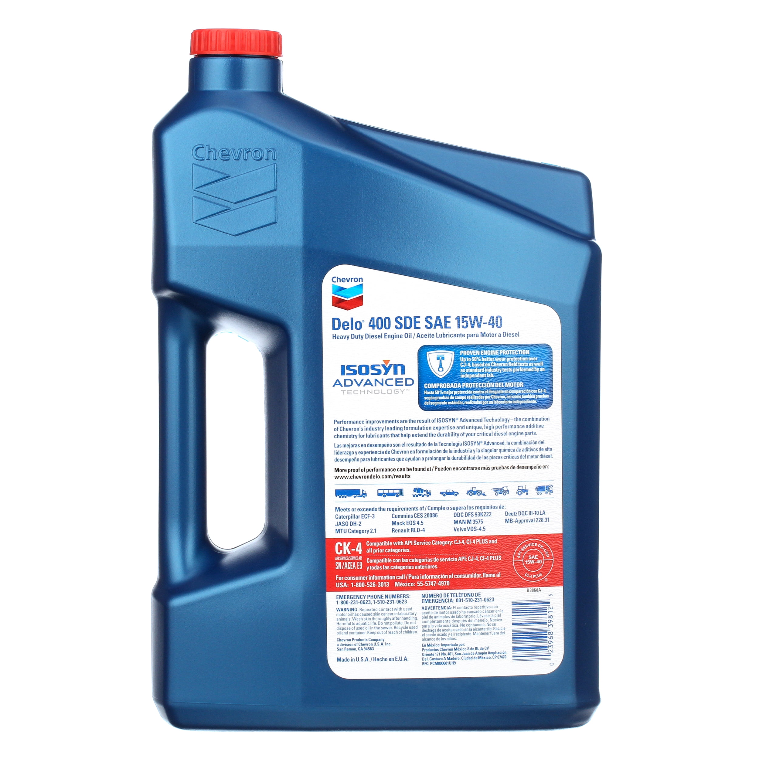

My clutch slips for a second or so when I hammer the throttle in 2nd gear, is it time for a clutch replacement soon? I understand there's no adjustment, though the clutch seems smoother now that I changed the fluid.
I'm using Delo 400 15W-40 in the crankcase, as I do with all my vehicles (they're all diesels except for the bikes)
Any advice?

The clutch issue is most likely caused by the use of oil with friction modifiers. That oil may be great for your car but it’s bad for the clutch on your Valkyrie.
You asked
I would change the oil with a cheap oil without friction modifiers then add one of those rinse products and then drain. Then refill with a quality synthetic motorcycle compatible oil. The problem will likely solve itself

Oil was my first guess too... I don't remember the specification that should be avoided, but
it would be listed on the bottle... I've added links to large pictures of the bottle... there's an
additive that's good for cars and stuff but is bad when you have a wet clutch that runs
in the same oil as the engine - like on motorcycles... so "motorcycle specific" oil isn't
the same as "snake oil"  Wink ...
front:
https://i5.walmartimages.com/asr/4b5e52ec-df11-4f96-b98c-ec6f08be1345_1.7381e074752c73db7b2d4b04f1c05aed.jpeg
back:
https://i5.walmartimages.com/asr/a8f5fa3a-584e-407b-b154-427584ec3ff7.0a237604bda59220b6ee89f1acd1a537.jpeg
I hope it is oil, that will be cheap and quick to fix...

I think you guys are right, so I ordered what I need to do the job. For some reason I thought Delo 400 didn't have anti-friction additives, maybe my thinking is tied to years ago.
I'm using Liqui Moly Pro-Line engine flush to clean it, recently an oil change was done along with the new oil filter of course, I'm not planning on changing the filter. The motor flush should clean everything out pretty well, looking forward to trying it out after the changeover.
Thanks for the help  cooldude, I'll be back to this thread for an update after the operation is complete.
