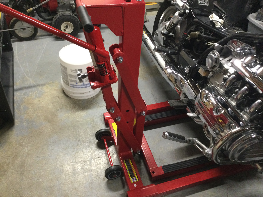

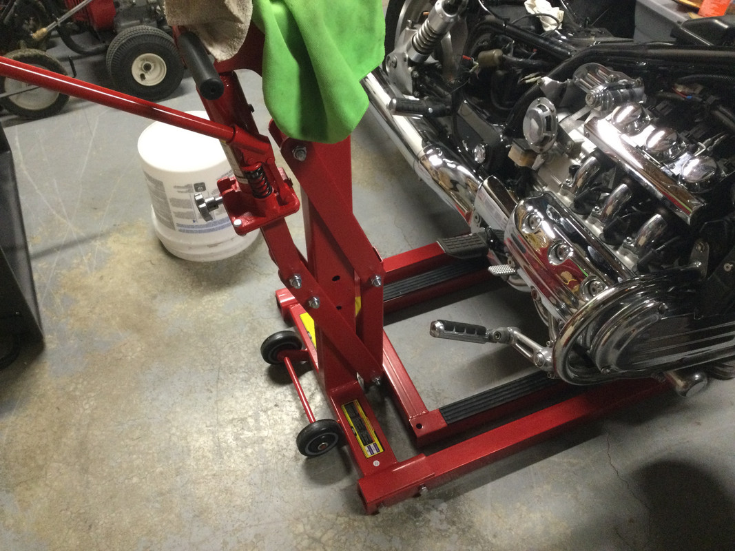

I bought this lift site unseen other than a picture since there wasn’t one on display.
I figured I would have the bike on a lift for a good while and I wanted maximum stability and I hoped the wide base of this unit would fill the bill.
The lift will raise the bike 30” off the floor almost double the height of the most common jacks being used which I thought would be of great benefit too. The lift had no problem lifting the bike and at full lift you could access the bike sitting or standing with ease. I should have taken pics with the bike on the lift to show this along with the issues I didn’t like.
#1. The arms that do the lifting were so wide that the lift adapter I got from MarkT barely reached the two edges of the lift arms. I initially thoughts that their width would add to stability but other issues negated that idea.
#2. The lift came with two wheels that only contact the ground when tilted backwards. Works great for mobility around the garage but the two arms that set on the floor and support everything won’t go under the bike while tilted so placement is difficult especially given the limited range of placement in order to line up with the lift adapter.
#3. Once under the bike and you think you have it where you need it, you realize that the lift arms swing in an arc, so you have to reposition the lift as you pump the jack to make sure the lift arms engage the lift adapter where you need them. Difficult since you have no wheels to help in the process.
#4. Once you have the bike in the air, the first thing I noticed was that the bike was not level side to side. This was just a design flaw for lack of a better explanation and there was no option for fine tuning. I guess you could develop some shims to rectify the problem.
#5. Finally with the bike all the way up and the provided safety pin in place you realize that all the stability you have is from the two parallel arm linkages from the jack to the lift arms and the whole bike would/ could sway with the clearances in the design.
So for $220.00 it was far from what I had hoped for. It works and is usable but it’s deficiencies were enough for me to return it to the store. I still haven’t replaced it with anything but will probably go with the floor jack design.
