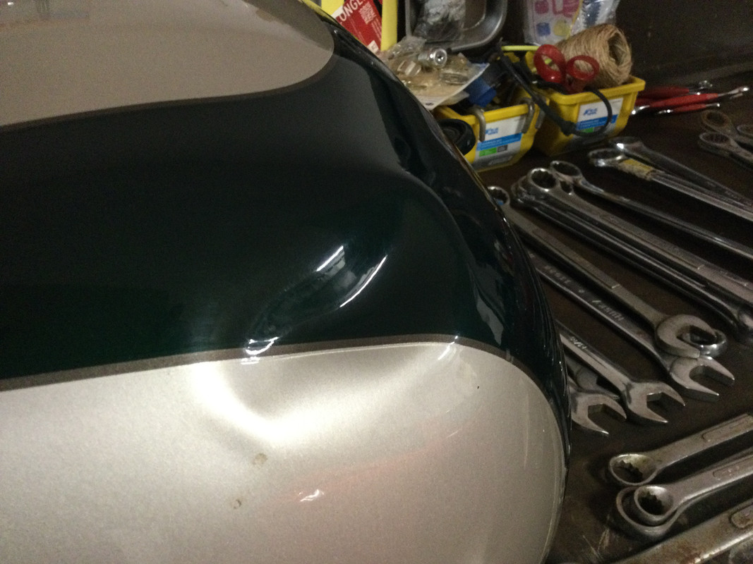

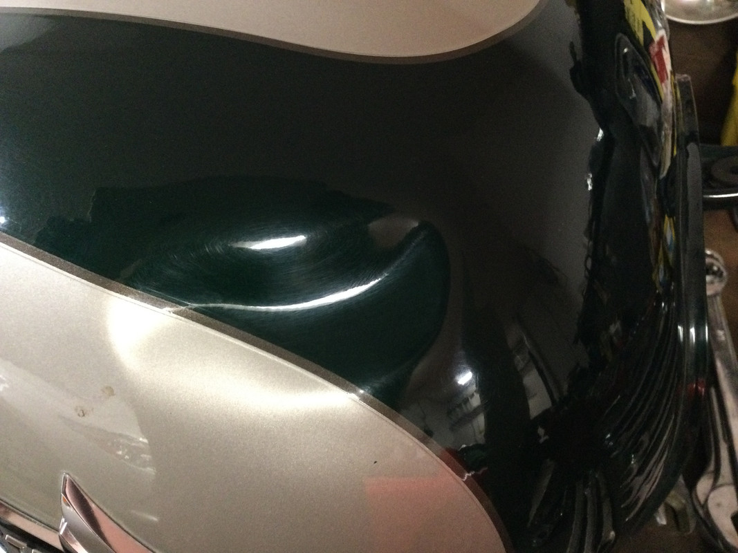

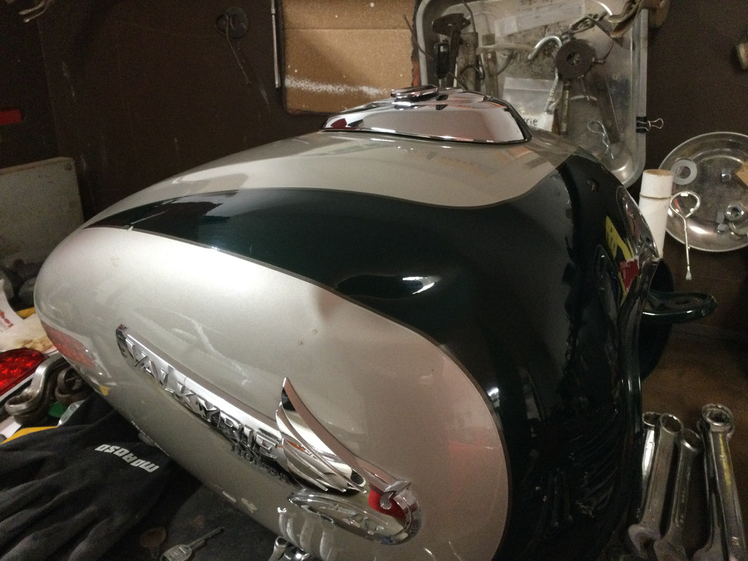

I got this Interstate tank Monday and I’m wondering if the dent can be pulled with one of those glue pulling setups for paint less dent repairs. I’m not trying to save the paint as I don’t have a green bike. I just thought I might want to try and pull it back into shape myself. What say you?

The pictures show a pretty good crease at the bottom of the divot.
That is going to be tough to just pull out.
Me, I'd find the right shop to fix and paint it all together.
You can always make it worse on your own.  (I know I can)
(Not that it matters), that didn't happen in a git off, something fell on it.
