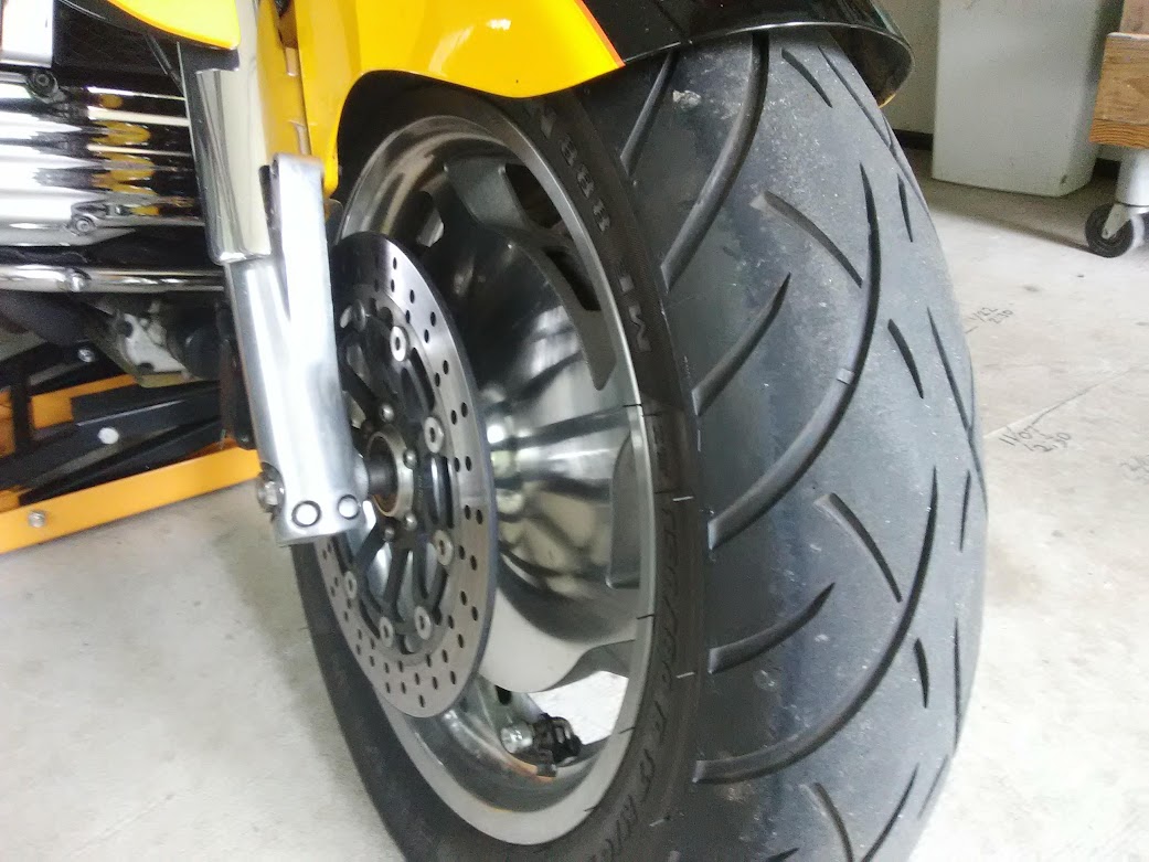

I received the Pinwall wheel yesterday, got some time today to make a first pass at cleaning it up and surprise,, it is a 1 J wheel.
Now the wheel came off an Interstate, don't remember the year and the information and video is already gone, but it was listed as
1 x    USED Honda Valkyrie GL1500 FRONT WHEEL RIM (1999-2001 CF Interstate 2003 CD Deluxe)
does that suggest the owner had a 97 wheel on his Interstate, or is there some other explanation? When I pull my front wheel off, I will check for the bearing differences.
It's all good anyway I look at it as the tire was what I was after,, having it already on a good wheel is just a bonus.    There is a bit of work to do first as the wheel still has an original type valve stem, and no wheel weights or balance beads installed. I will break it down and change the valve stem and add three oz of beads before installing it.  I think my present tire can still make it for a couple of days.

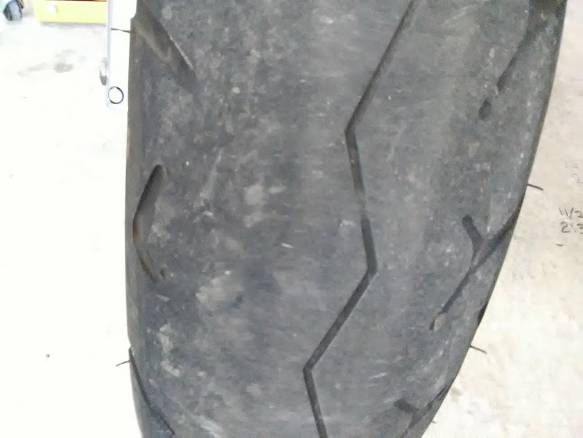

I got thinking about it, and realized that the front left seal (edit: I mean right side seal) will have the same outer diameter as the bearing in that position, so I could see what bearings were in the Pinwall wheel without removing the wheel from my bike. I measured the seal at 47mm, so I also have an Interstate wheel with 6204 bearings that is cast with the 1J marking..?? I don't see these wheels still being left over from 97 f-stop, maybe to your 98, but to a 2000, that's a lot of bikes gone by, there must be more of an explanation.

Pancho what is the DOT number on the tire
Cowboy, the date code on the Bridgestone is 1317 (that tire lasted awhile), and the code on the Pinwall 888 is 3519.

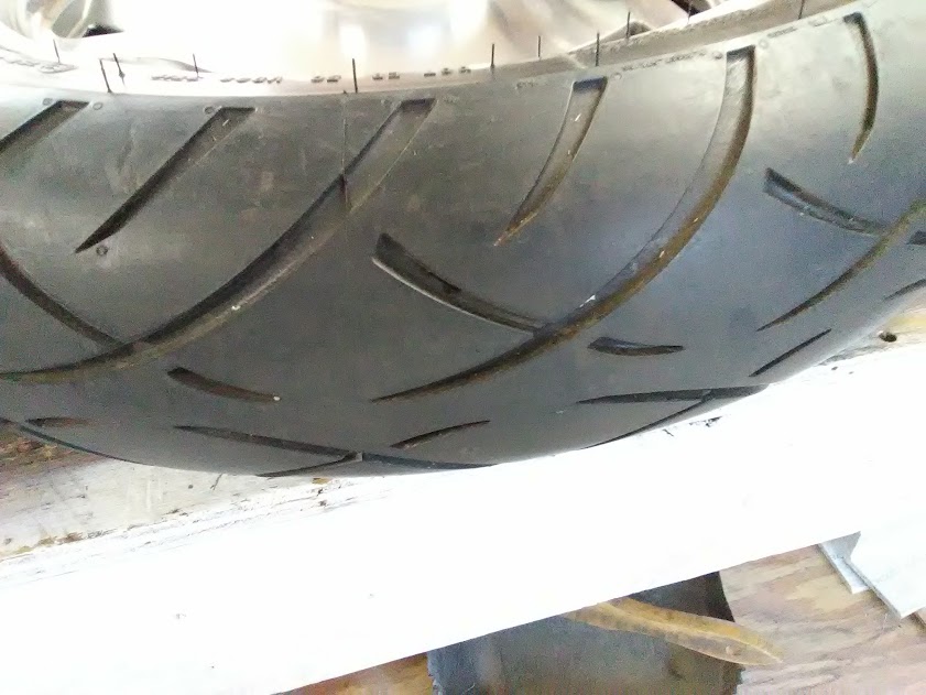

So I cleaned up the Pinwall wheel and installed it and rode on it awhile and like the way it feels,
so I check Pinwall again to see if I can find a rear 888, and find a Valk rear wheel with an low mileage 888 and buy it. I clean and polish the wheel only to discover that the wheel has been run without a thrust washer and has suffered damage.
Here is a good surface
I call Pinwall and send them pictures and they tell me to keep the wheel and they send me another at no charge. I get this wheel, (nasty and needs a lot of cleanup) and it has a good Metzeler 880 on it. About seven years old but not out of my comfort zone and I will ride on it till it's gone, other wise in good condition with the thrust washer face in good condition.
So this all started because I needed a front tire and could not find one at my regular sources. Yes I did spend several hours cleaning and polishing, and need to change a couple of tires around, but I end up with two like new Metzeler 888 tires, a good Metzeler 880 tire, a good spare front Valkyrie wheel, a good spare Valkyrie rear wheel, and a damaged Valkyrie rear wheel which can be used if I mill the surface flat and use three thrust washers. This was all for a little over two hundred dollars,, (free shipping and no tax if you buy from their website and not eBay. your results may vary.
Two thumbs up to Pinwall Cycles and the gal who handles their customer service line.
I guess the car tire is coming off for awhile, and I will go back to MC tires, see if I have been missing anything.
